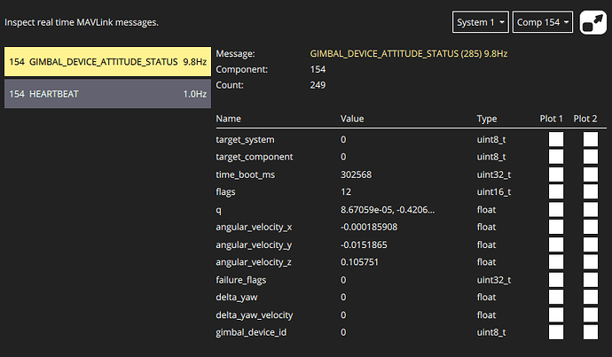

Hello everyone,
I’m trying to control the Siyi A8 Mini Gimbal with MAVSDK. The Gimbal has been updated to latest firmware (v0.3.7) and is connected via UART to Telem2 on a Pixhawk 6x. I’m running the gimbal.cpp example. The error messages seem to indicate that there is an issue while sending data to the gimbal.

Wiring:
MAVlink Inspector
Params:
I referred to this recent post - Siyi A8 Mini with PX4 1.14.3

What could be the issue? Can someone please help me troubleshoot this?
Update: I’m able to make the gimbal move by reducing the baud rate to 9600.
But I’m still encountering warning and error messages. Additionally, I frequently can’t detect the gimbal or take control, resulting in timeouts. How can I resolve this issue?
gimbal/build   main ±  ./gimbal serial:///dev/ttyACM1:9600
