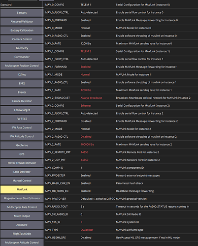

I am having a hard time getting a Siyi A8 Mini Gimbal Camera to work with PX4 v1.14.3 Stable. The Gimbal has been updated to latest firmware and is connected via UART to Telem2 on a Pixhawk 6x.
The parameters used are:
MAV_1_CONFIG: “TELEM2”
SER_TEL2_BAUD: 115200 (complying with siyi specification)
MAV_1_MODE: “Normal” and tried “Gimbal” aswell
MNT_MODE_IN / OUT: Mavlink v2 and tried v1 aswell

First, let me say that I was successful in getting the PX4 and A8 MINI to connect and even control via the MAVSDK example on the ground. FC worked successfully with cube orange, pixhawk v6x, pix32v6, and cuav x7.
First, check to see if the FC parameter window exposes the Component 154 entry at the very bottom. If you do see the Component 154 window, set set_att_en to 1 inside that window. The rest of the parameters are probably the same as mine.

set_att_en is at component 154 window.
And below is my parameter.
I connected A8 at Telem2/MAV1.
I hope my reply helps you solve your problem.
set_att_en did solve the issue, it was set to 0 before. Took me a moment to find it in QGC, because it only showed up after selecting Toos → Refresh and i also couldn’t find it in the docs.
