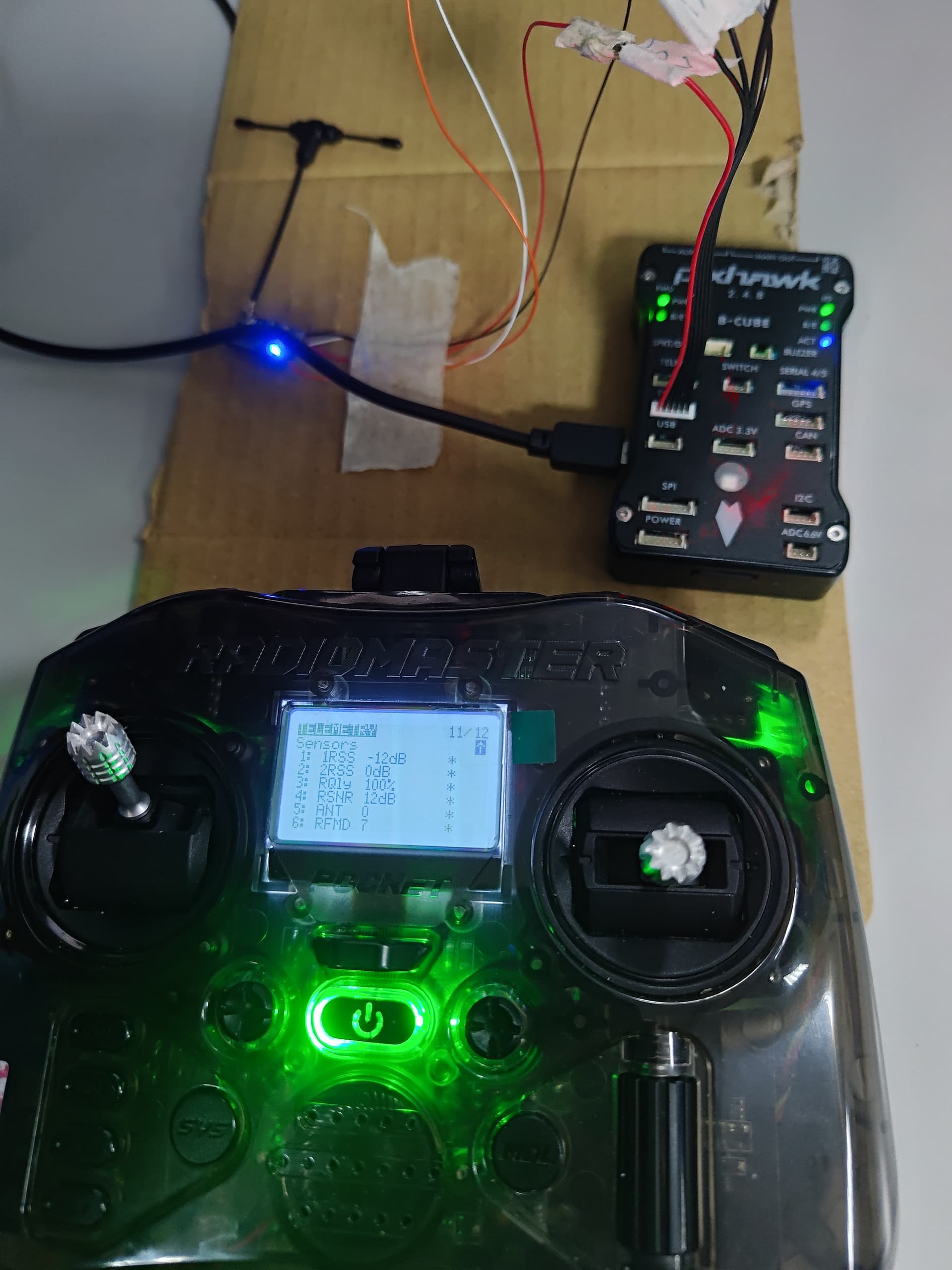

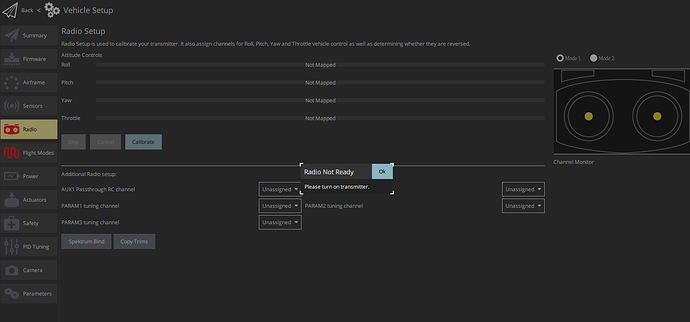

I am using a Pixhawk 2.4.8 with a BAYCKRC 2.4G receiver (baud rate 420000) connected to the TELEM2 port. The receiver is successfully connected and bound to the transmitter (RadioMaster Pocket 2.4G). However, the Pixhawk cannot communicate with the receiver, and the Radio Setup in QGroundControl (QGC) shows “Not Ready.”

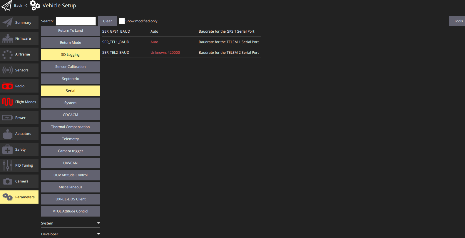

I have set the QGC parameter SER_TEL2_BAUD to 420000, but the issue persists. I also tried connecting the receiver to the TELEM1 port, but it still does not work. Additionally, the Pixhawk’s red LED keeps blinking continuously.

Previously, I connected a serial interface (PL2303GC) and a receiver (BAYCKRC), and I was able to view CRSF logs in PuTTY. This suggests that the receiver supports CRSF communication via its TX/RX pins.
Based on this setup, how can I configure the protocol radio in QGroundControl when connect Pixhawk and receiver? Thank you.

Hi Julian:
Default PX4 don’t contain this parameter(RC_CRSF_PRT_CFG)
I try to local build that PX4 could get CRSF protocol data via TELEM1, many thanks!
