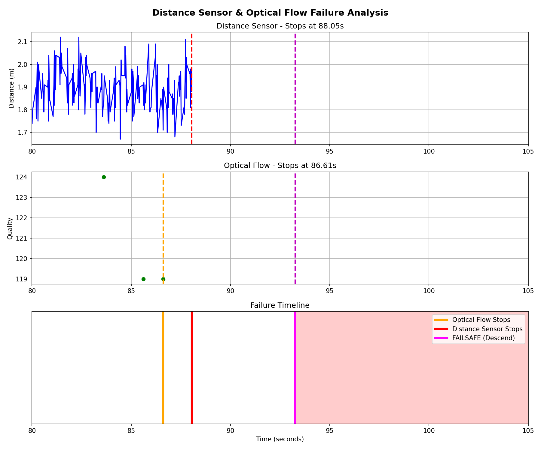

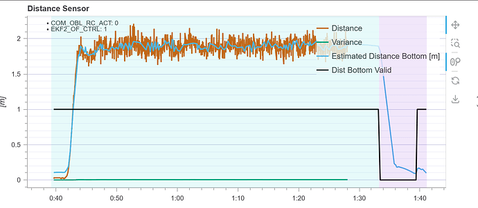

After rebooting, the copter functions normally. This has happened on several occasions.
Any idea frome the log?

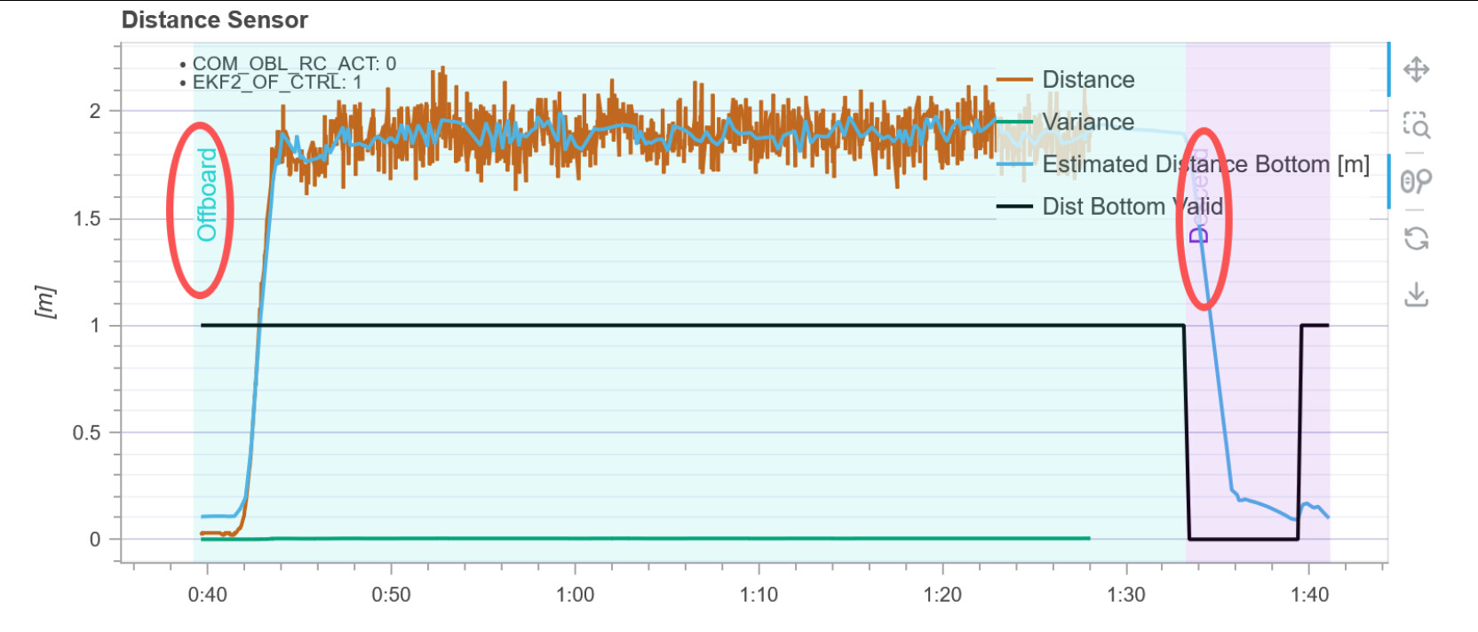

I also do not think this is related to the mode switch.
Distance sensors are not known to be extremely reliable, so having one fail is plausible.
Yes, it’s NOT mode switch issue.
It seems there are op data lost before mode switch.
| Time | Event |
| 39.66s | Distance sensor starts (normal operation) |
| 40.62s | Optical flow starts (low quality) |
| 86.61s | |
| 88.05s | |
| 90-93s | System dead-reckoning without ground reference |
| 93.26s | |
| 93.26s+ | Position control disabled, altitude-only control |
