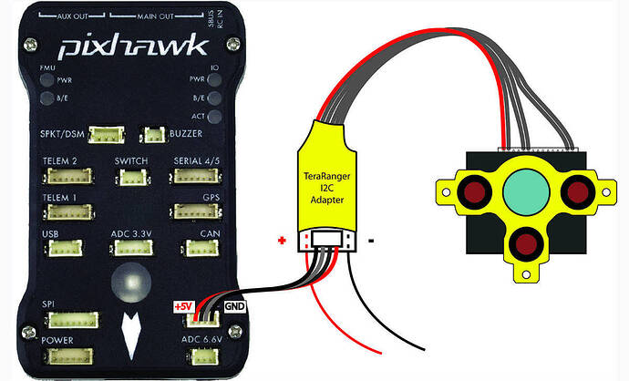

Can the trone.cpp driver in the PX4 flight stack be used as an altimeter (pointing face down)? If that is the case, then are there any parameters to be set via QGC (e.g. min/max distance, etc.)?
I can’t see you picture.

The Terraranger is connected with PX4Flow to I2CBus. This config work with Arducopter so my Terraranger is well flashed with I2C support.
The picture should show now.
BTW, Lorenz and Julian are going to try to test the sensor so they might post results in the former PX4 forum.
Yes, I see the picture now, thanks,

Actually TeraRanger One was not working out of the box with PX4. I submited a PR to add configuration parameter:
As a workaround, for now, you can edit
ROMFS/px4fmu_common/init.d/rcS
and add line
trone start
Then you’ll need to rebuild the flight stack and flash your device.
