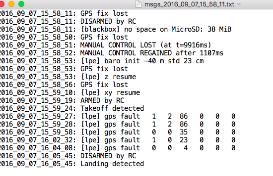

Can you share a screenshot of all QGroundControl messages when you try to arm?
I had my last flight with older FW with a log file.
With 1.4.4 there is no log file. The system didn’t arm.
Just a messages file, which could reveal the QGroundcontrol messages.
Shown below is a file from 1.4.4 and an older one from the flight before.

If you do not run a racer config you either need to use the safety switch or disable it in the circuit breaker section (Cogwheel -> Parameters -> Circuit breaker -> set to max value).

I am back on 1.4.4 and for me the circuit breaker for IO-safety did the trick, as Lorenz mentioned above.
Parameters -> Circuit breaker -> IO-safety -> set to max value.
I used the airframe “3dr diy quad” before and now am on “generic quad”. These only give presets for tuning and other parameters that can be changed individually later. Circuit breaker seems to be the only value one has to change for pre flight checks in order to arm.
