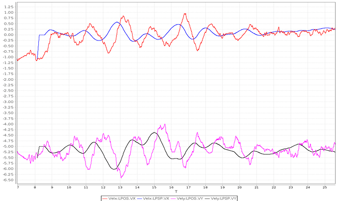

Hi everyone,
I’ve tested 1.4.1 rc3 with my tachymeter tracking setup. In general I’ve been able to tune MPC PID parameters to achieve stable position control with LPE.
There are however a few things that I don’t understand.
  1. The spikes in setpoint velocity look weird, will the further PID tuning help eliminate those?
  2. At T=100 the estimator seems to break?
http://logs.uaventure.com/view/u42kUDFPpdKjyFwtUaq5ET
Appreciate any feedback.
I need to look at the plot in detail. The estimator resets its internal position to zero at arming, which is what you’re likely seeing. I need to inspect that behaviour again. I just merged a couple of further improvements to beta.
@Sn0west Will look into your log again and suggest changes. The other issues reported here should be fixed on beta.
