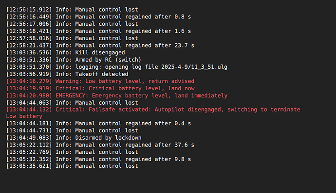

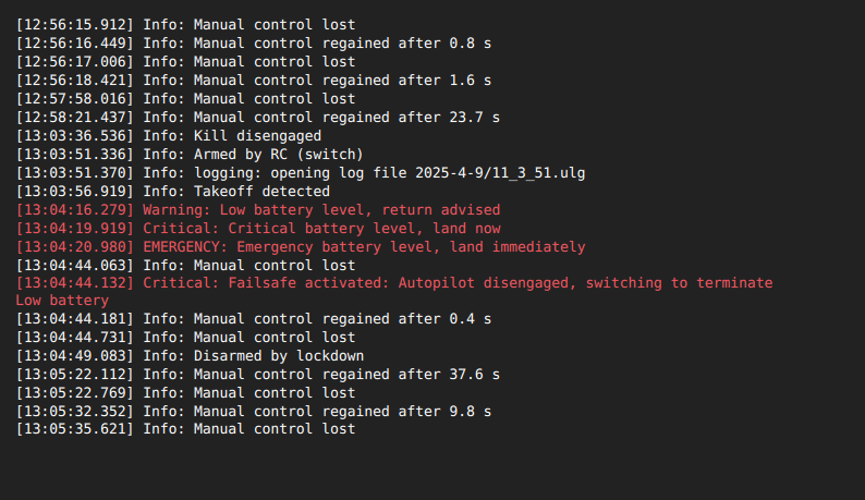

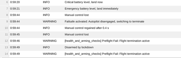

During one of our indoor tests in Stabilized Mode, approximately 40 seconds after the autopilot detected takeoff, the motors suddenly stopped. If the drone had not been tethered, it would have crashed. To determine the root cause of this incident, I analyzed the flight logs (link here), reviewed the PX4 source code, and used the failsafe simulator to test various failsafe flag configurations.

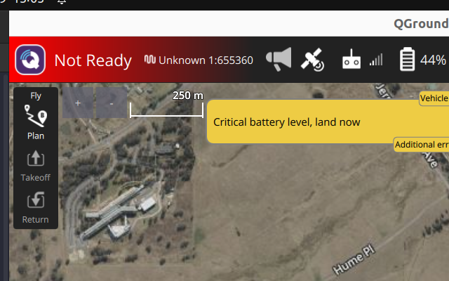

QGroundControl displayed an unknown error message (Unknown 1:655360) at the time of the failure. Despite attempts to reproduce the issue under similar conditions and with our current parameter settings, I was unable to replicate the behavior observed during that specific test.

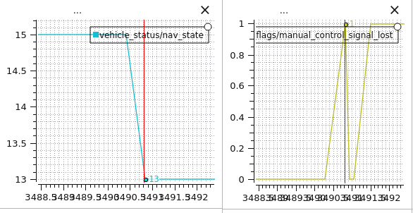

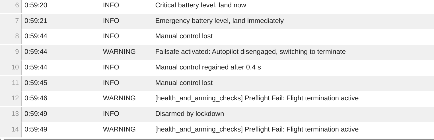

The autopilot switched to Termination after the loss of manual control. The configured behavior after a manual control loss, NAV_RCL_ACT, was set to RTL.
RTL though requires a valid global position estimate, which in your case was not given. The system is then falling back to the next possible failsafe mode, which in your case was Termination as beside not having GPS or EV lock, you also had baro fusion disabled and thus all height rate controlled modes are not possible to be executed.

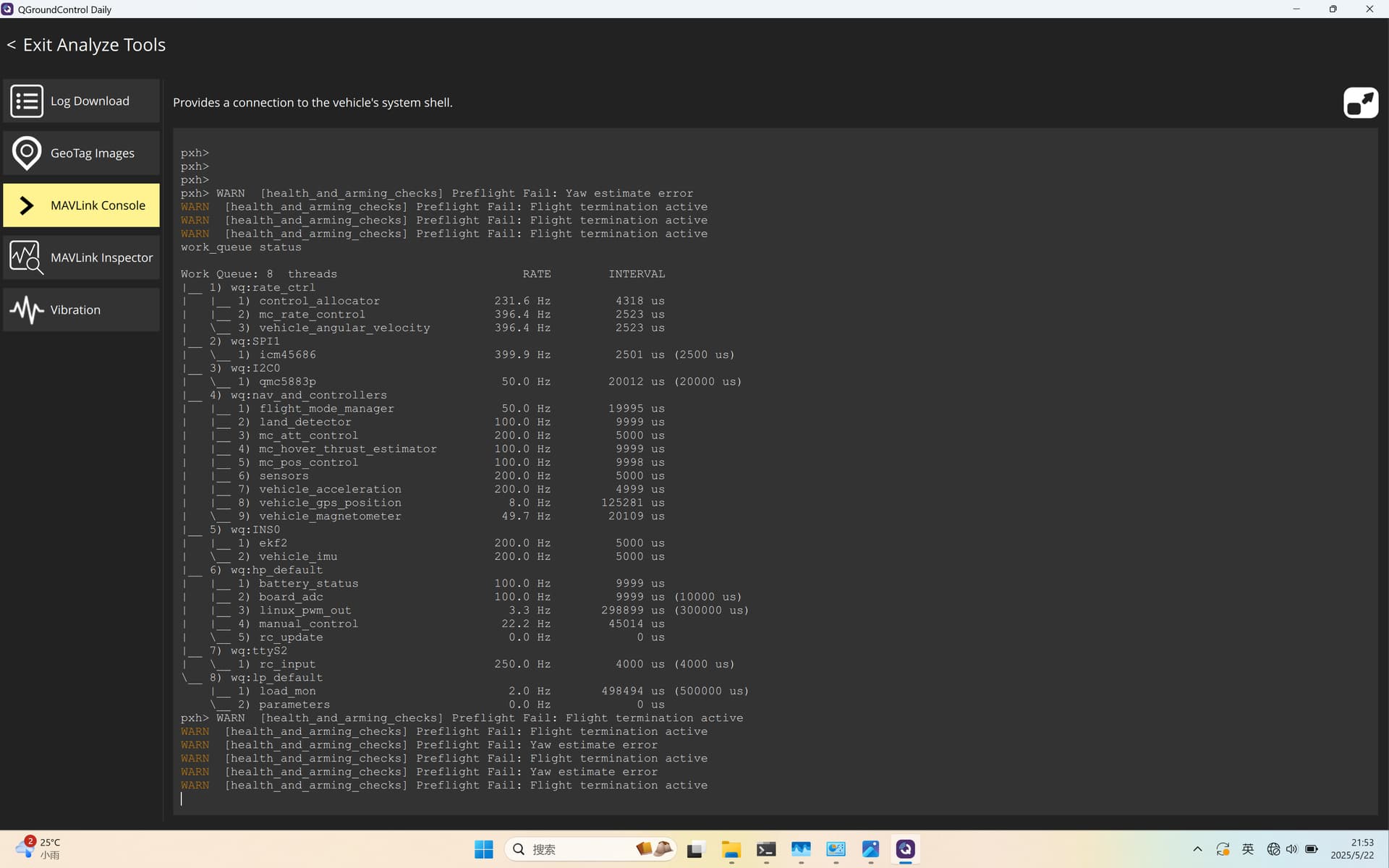

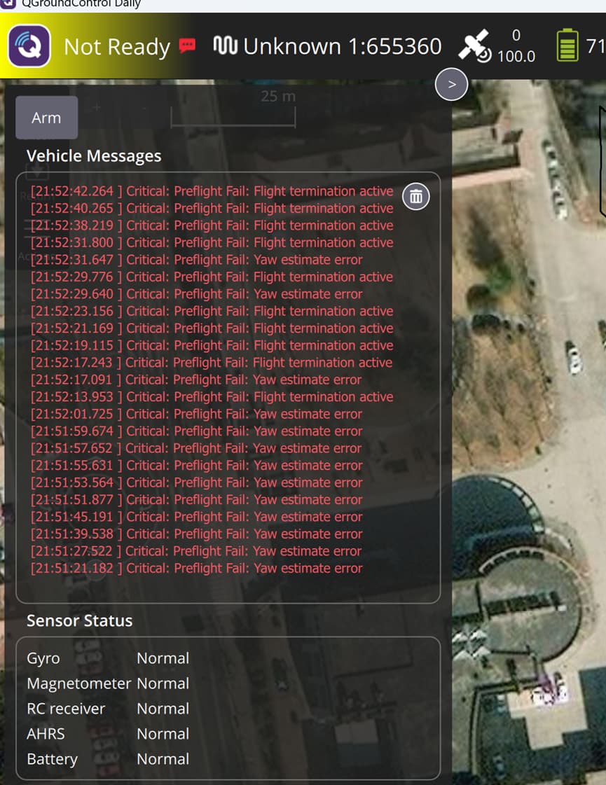

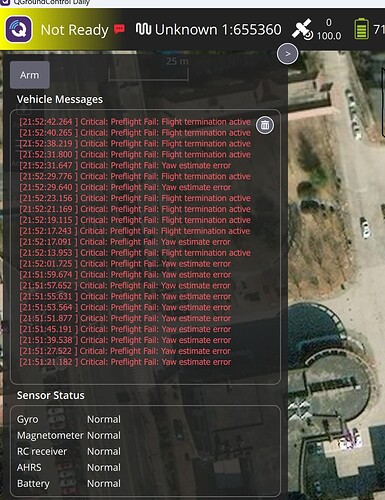

I encountered the same problem in my lab’s drone research flight, and we frequently encountered the 1:655360 situation. Sometimes it was when not unlocked, sometimes during flight, and sometimes after locking. It was quite random. After this situation occurred, the aircraft could not be armed, and the flight control’s pwm output was gone. I don’t know what the reason is.
