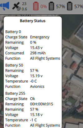

we have the same problem of our vehicle randomly entering rtl or loiter mode because of a low remaining flight time. We already use a version including the pr mentioned by @sfuhrer and have set the COM_FLTT_LOW_ACT parameter to None, but seems like it still enters failsafe when the remaining time is just one second.
The QGC Mavlink Inspector the battery status of a battery id 255, with remaining flight time 1s, but We never publish any mavlink message with this battery id, just one coming from a secondary component (26) with id 50 and the one from the power module with id 0. Both with remaining_time 0 (which is treated as nan according to mavlink documentation ). I suspect this code in the pixhawk firmware somehow messing with the uorb message (id flips from 0 to 255 due to -1 on an uint8 and the max() function sets the flight time remaining to 1 instead of 0. The faulty message gets published by component 1 (the pixhawk) but copies the voltage published by the secondary component under id 50.
(the emergency battery is just because I used a 15V psu instead of the expected 6S when on the bench)

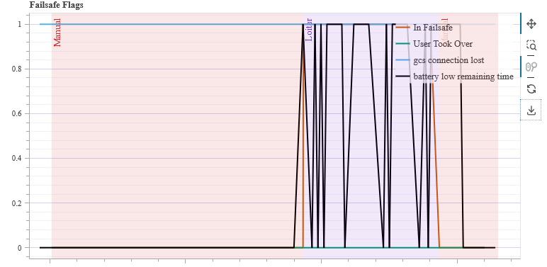

finally got to field test this yesterday, seems like the 1s remaining time doesn’t show up anymore in the mavlink inspector (the battery that was id 255 now shows up as id 1, but without a time_remaining value). But the vehicle still enters failsafe after a launch is detected and the uORB failsafe_flags topic (checked via the listener command) still shows the corresponding flag (battery_low_remaining_time) turn true. So our solution for now is setting the corresponding failsafe actions in /src/modules/commander/failsafe/failsafe.cpp to None. This seems to work, but permanently disables this failsafe. (@manudelu )
@moritzNeo could you share a flight log of your most recent testflight here? Where it still entered the failsafe even though it should have been disabled.

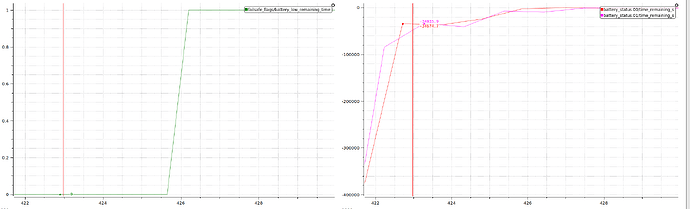

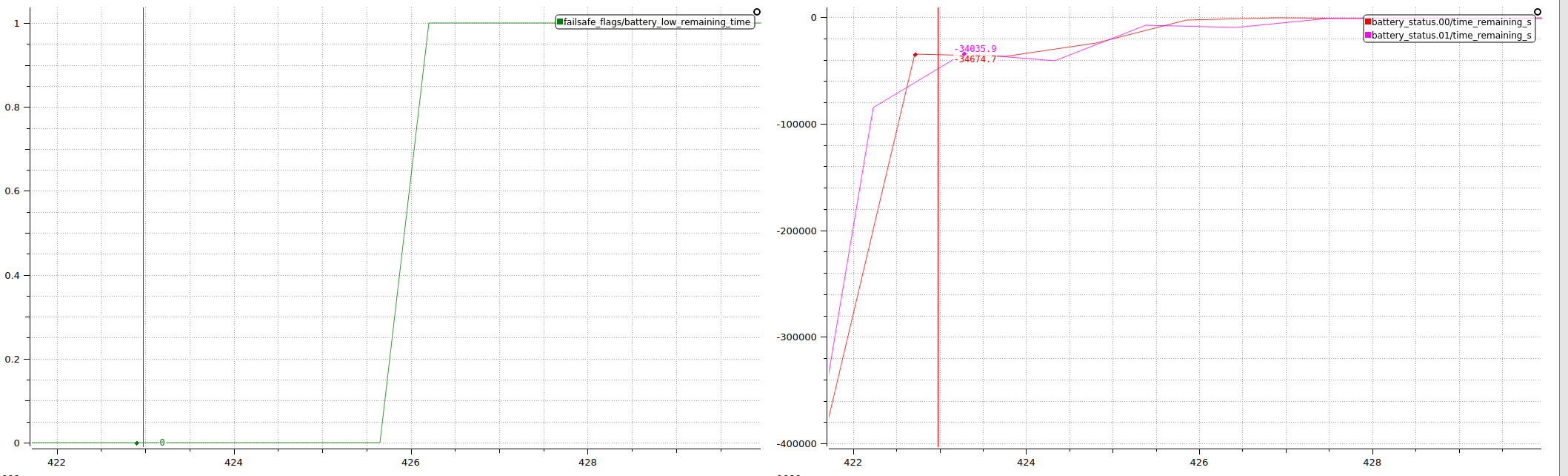

@AWilkins_Ascend I got this same issue today every time I took off on v1.15.0, even though I set COM_FLTT_LOW_ACT = 0.
Supposedly @AlexKlimaj fixed this in v1.13.0-beta1 UAVCAN Battery Can't Take Off Due to RTL Time Estimate · Issue #19642 · PX4/PX4-Autopilot · GitHub
This was my first time flying with Tattu DroneCAN Smart Batteries.
Log here
Can you test the v1.16 release candidate? There were some fixes in the failsafe logic since v1.15.0.
Would also be interesting what’s causing these negative time remaining estimates.
