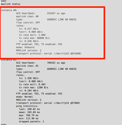

Oh, I’ve just tried to disable mavlink instance for onboard computer and started it from mavlink console and, wow, it works!
Look:
I’ll try to investigate it deeper, but at least it works somehow:
