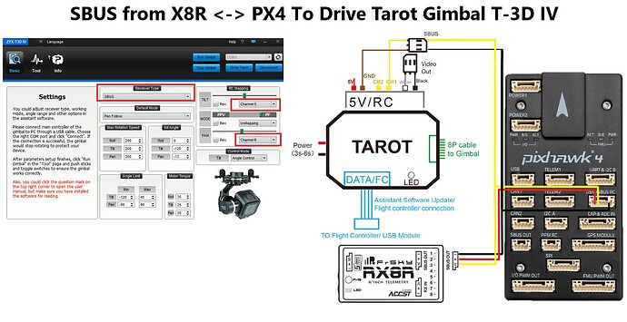

I’m trying to do something similar to you. So I just wanted to confirm that you are using the 3-pin SBUS OUT port on the px4? Unfortunately, I’m not getting any output on pin2 of that connector but I’m gonna scope it out tomorrow.
Hi Guaren,
Can you please describe your setup? You might be missing something…tell me what you’re using and I’ll try to help you solve the problem.
Thanks and good luck with your project!

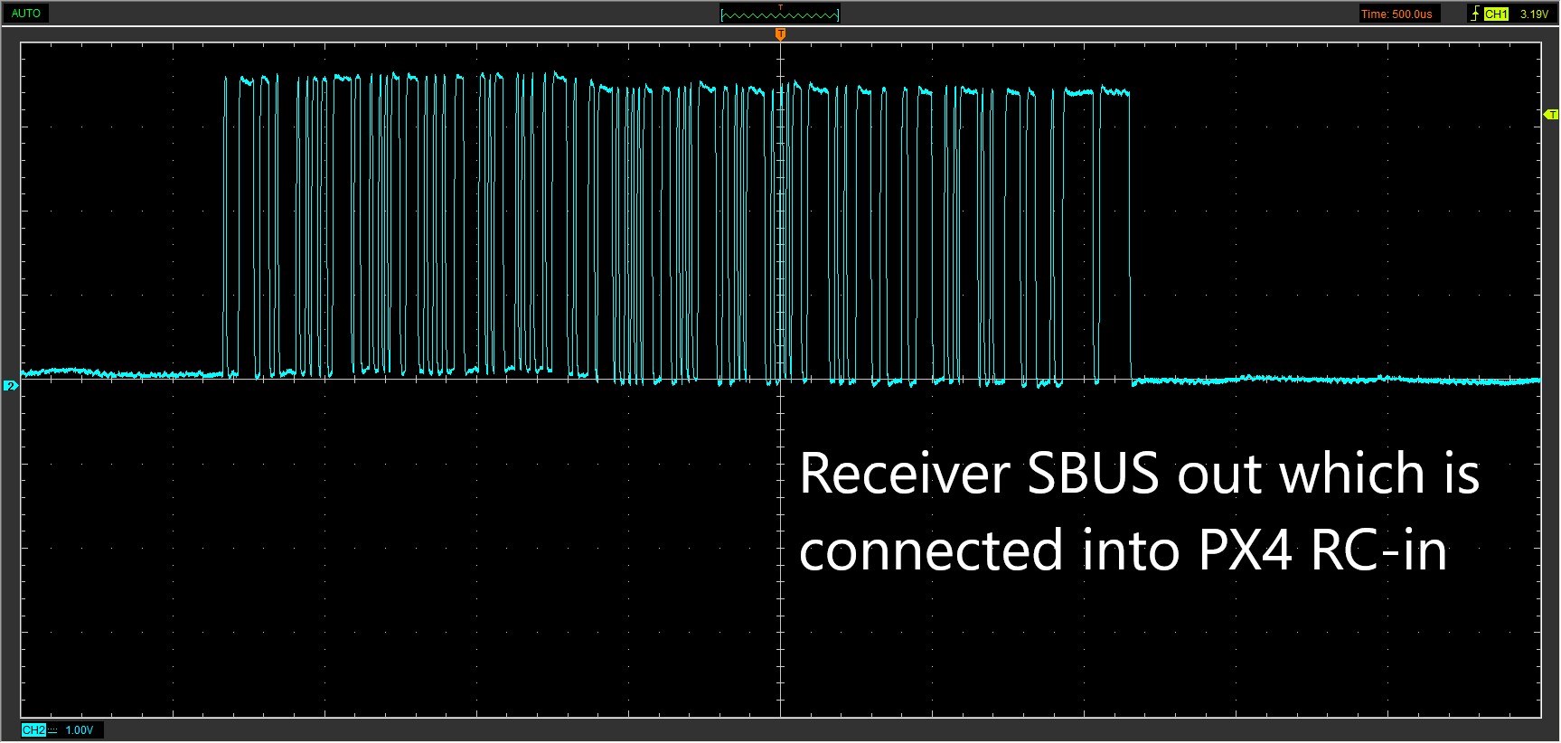

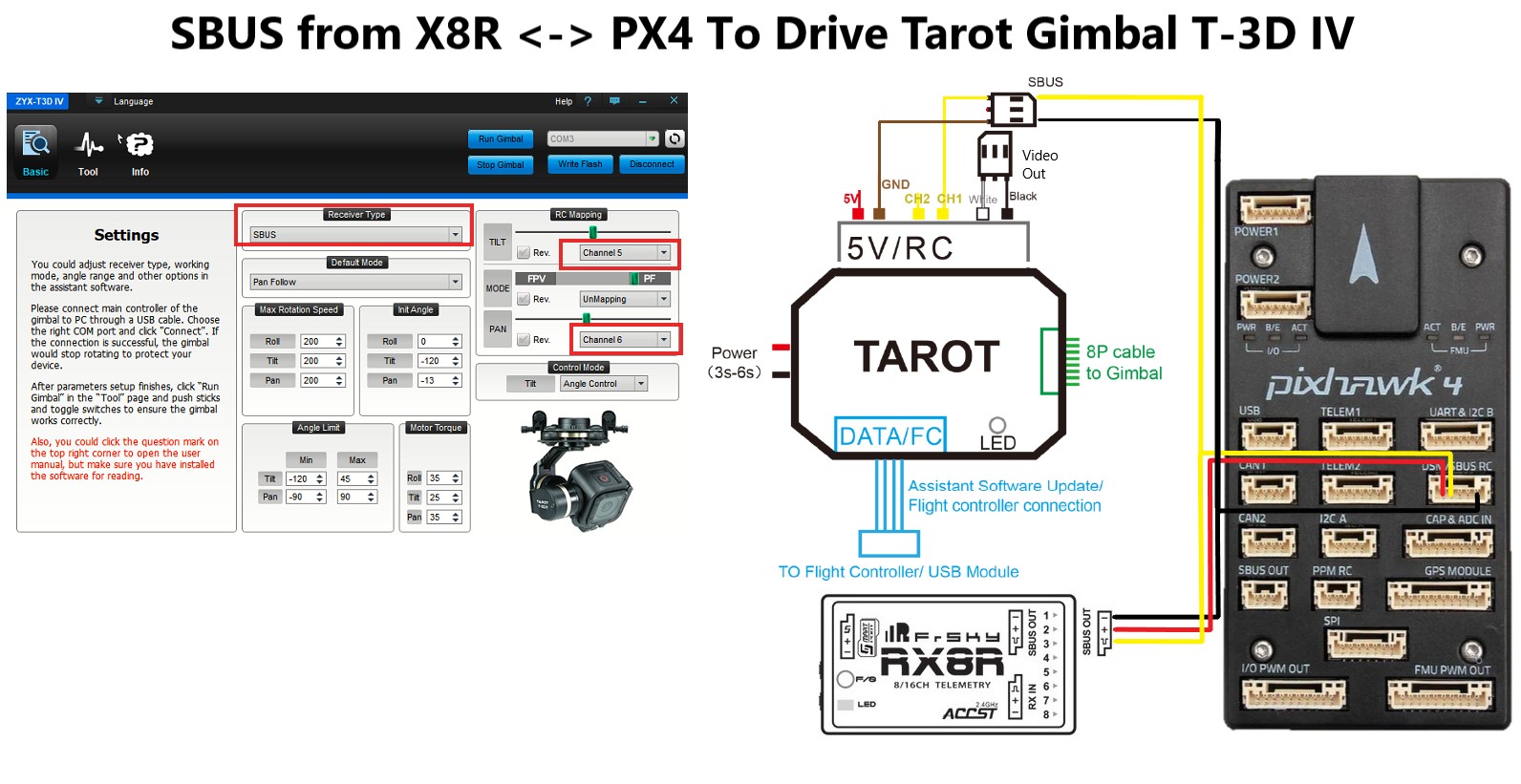

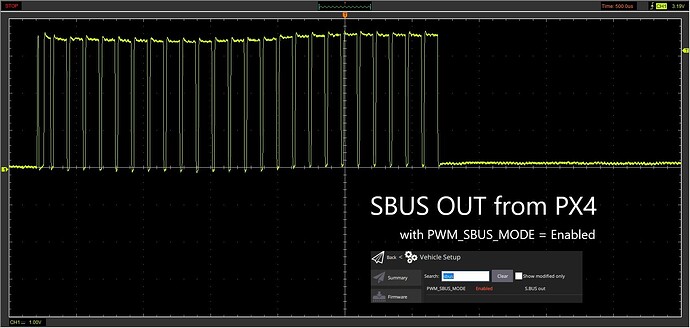

Hi Alex, so I need some kind of SBUS passthrough to control a gimbal and I thought that the “SBUS out” - 3 pin connector on the px4 would do it but I only seem to get the following waveform out of it (I assume is PWM) which does not resemble the RC-in waveform. The SBUS out waveform never changes, even with RC inputs and the PX4 in armed status. There must be some kind of trick to getting this to work but I’m not finding it.
Ok, so apparently this info is not available anywhere. I always assumed that the SBUS was point to point. Apparently you can put other devices on the same bus so that’s what I’ve done to drive the SBUS gimbal from the RC and effectively bypassing the PX4 as I could never get the SBUS out from the PX4 to properly pass-through.
