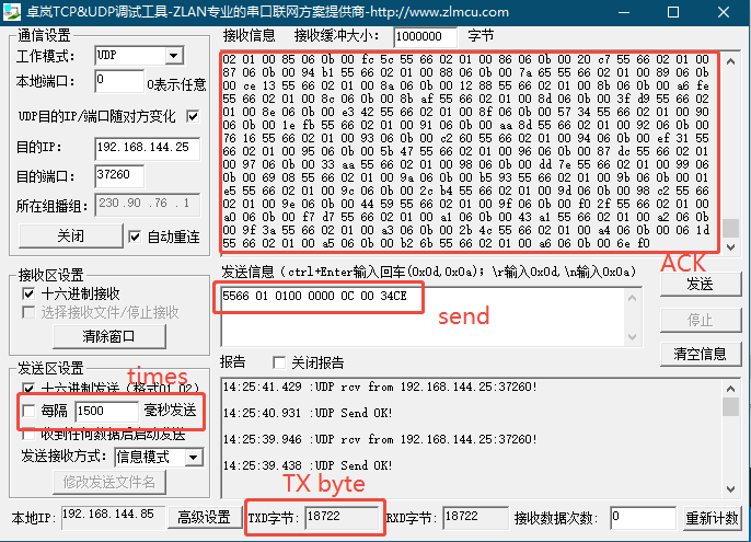

I took some time to use ZR10 for continuous photography testing. Send SDK command 0x0C to trigger photography, and send the command in a loop at intervals of 1500ms.
At present, a total of 18722 bytes have been sent, with each 0x0C command containing 11 bytes and sent 1702 times. Viewing the folder, a total of 1702 photos were actually recorded. I did not encounter the situation you described.

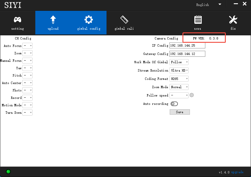

The current firmware of ZR10 is shown in the figure:
Please kindly send me the ZR10 firmware version you are currently using. Thank you.

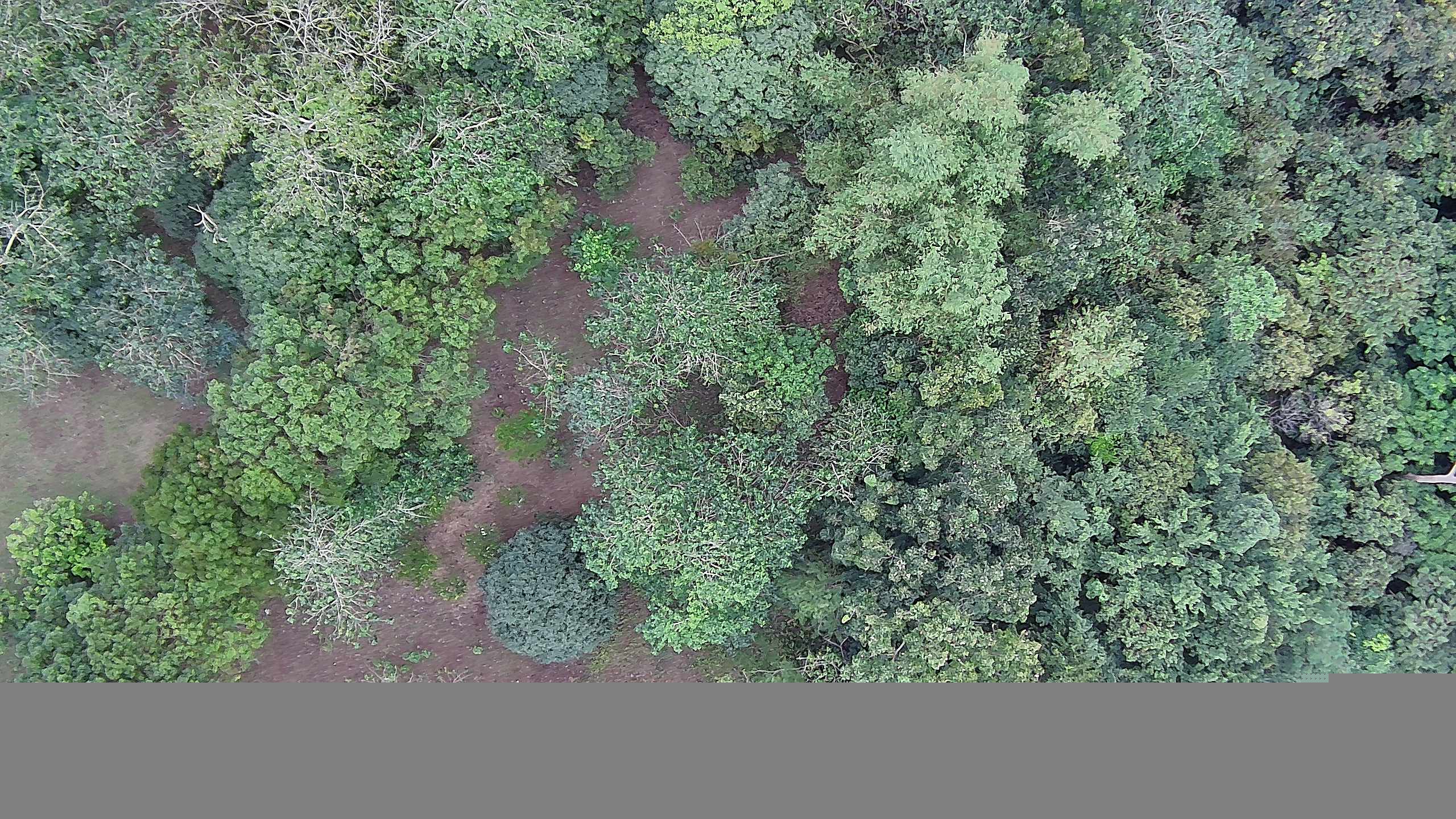

My only problem in Siyi ZR10 is when i set the mission in px4 to capture every 3 seconds, some of the captured image have grey part like it was not able to render the whole image properly.
what could be the problem there?

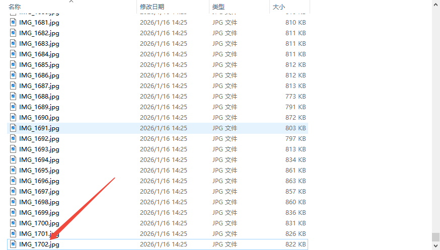

i see that you set zr10 to capture image every 1500ms and have gotten 1702 images. are all the images captured here is complete no greyed part?
What is the best SD card can you recommend for Siyi ZR10?
ill send my sample copy of the images with grey part and also the screenshot o firmware of the ZR10 by monday thank you
I checked over 300 consecutive photos from 1300 to 1700 this afternoon and did not encounter any gray screen phenomenon.

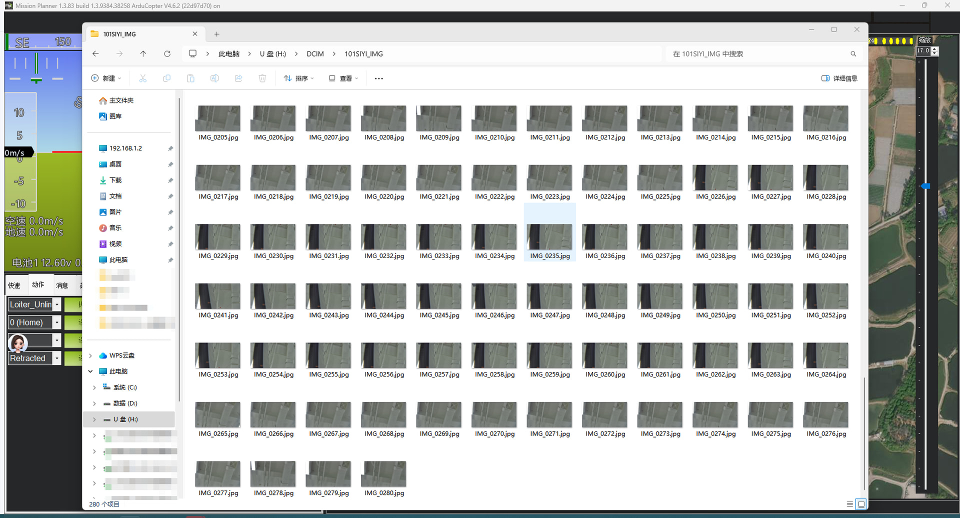

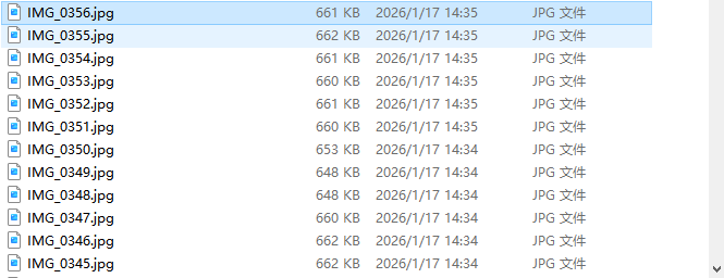

I did two rounds of testing this afternoon. The conclusion is as follows:
  1. Two tests were conducted, taking 280 and 345 photos respectively, and the situation of stopping shooting after 255 photos was not reproduced.
  2. I checked all 280 photos taken during the second round of testing and did not see any gray screen.
Test environment:
  1. Flight control firmware: ArduPilot v4.6.2 firmware
  2. Flight simulation software Mission Planner: v1.3.83
  3. Trigger photography through MAVLink protocol
  4. Automatic shooting of planned flight routes

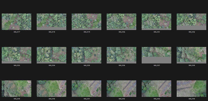

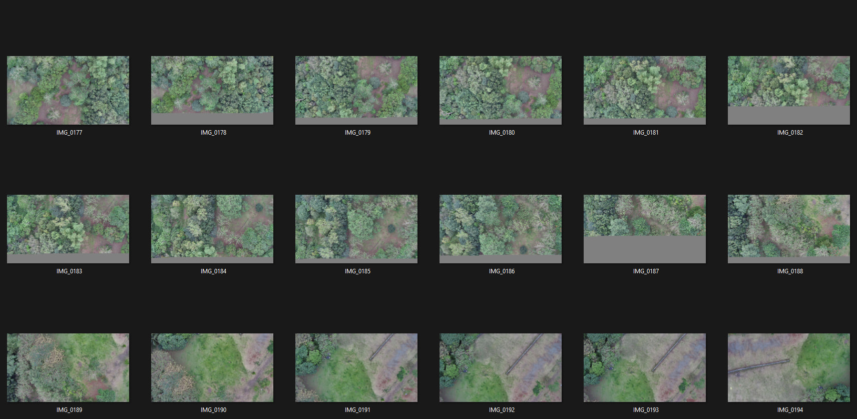

@JulianOes I’m sorry I can no longer locate logs for this image capture during mission that stops triggering capture image once the image count is 255. Ill try to recreate the mission and submit the logs here this week.
@SIYI_Support Hello this is the sample of grey part images we encountered during mapping.
something like this.
its not happening in one image only.

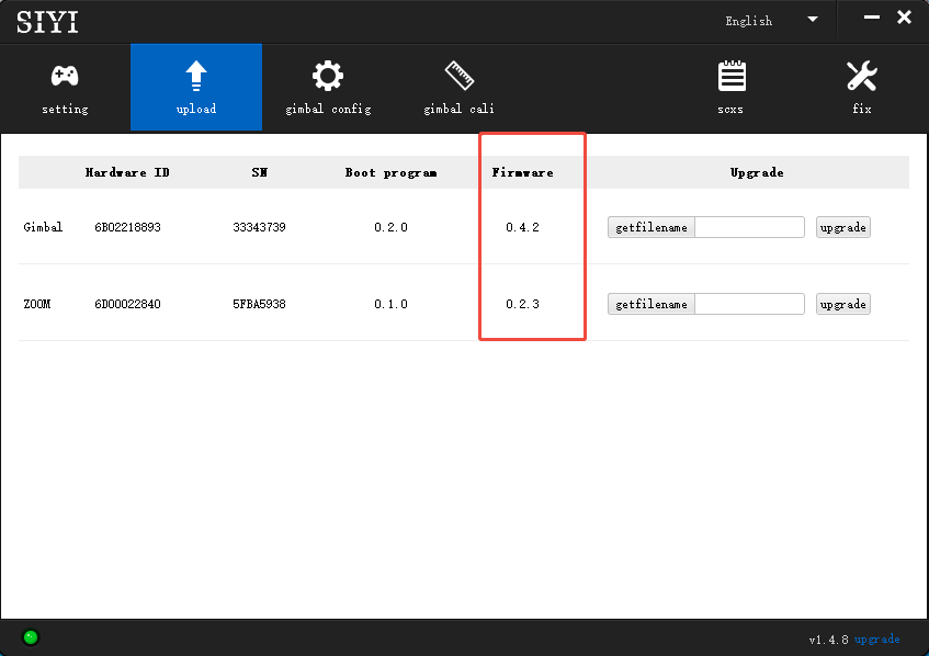

also for the firmware of our ZR10 I forgot to take screenshot but it is same like what you posted
I updated it last month using the firmware posted in siyi website for ZR10.
Gimbal Firmware is v0.4.2
Zoom Firmware is v0.2.3

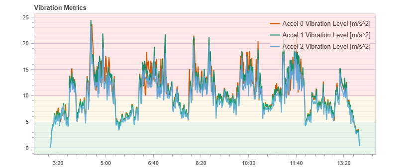

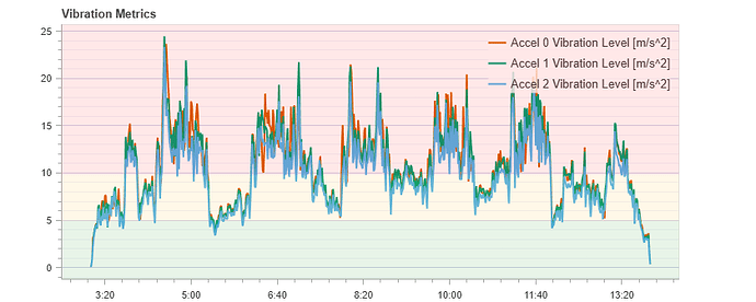

this is the vibration of the UAV during mission ( mission + capture image every 3 seconds)

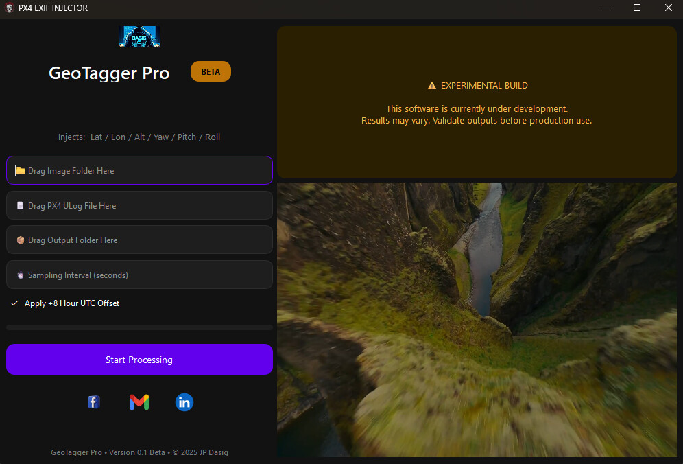

Currently I built a python app for injecting GPS (lat, long, and alt) , Pitch, yaw and roll to images.
I noticed that when I capture images in siyi ZR10 the date is correct but the time is less than 8 hours in our time zone so I added in my app the automatically add 8 hours to all images.
so the images captured during survey mission can be used for photogrammetry (pix4d)

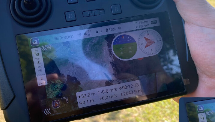

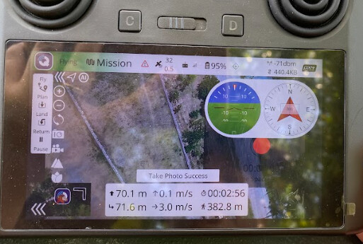

in this video the UI of qgroundcontrol is not showing any indication that the MT11 is capturing image but we can see the live stream is like stuttering like it was capturing image. we confirm in the sd card that it has captured images.
in Siyi ZR10 it displays notification in the middle bottom “capture image success” every time it captured image. when it stop capturing image we can assume it reach 256 images captured.
in MT11 we cant say when the camera reached 256 images captured( which is a problem ).

In ZR10, Images have no Geotagging in its metadata. the time used is UTC 00 so during GPS injections I add +8 hours to all images then I used the ULG(pixhawk Logs) To match the GPS based on the time and date.
Note that, in this test I used only 1 drone. I just changed the camera. Params that was set on Px4 firmware in QGROUNDCONTROL was used in both Cameras thru Telem port 3 in the pixhawk 6c.
@SIYI_Support The Date and Time in ZR10 images where in UTC base so I need to add +8 hours to every images it captures to match the exact time and date it was taken.
When I use MT11 it sometimes gives Correct time and date but some it does not give correct time and date and have dates of 1970-01-01 12:00am. though Im currently not thinking about it since all of its images have geotagging already.
For now, Im using an app written in python to add +8 hours to each images then injects the gps on each images base on time from the Ulog file of the drones it was used.
