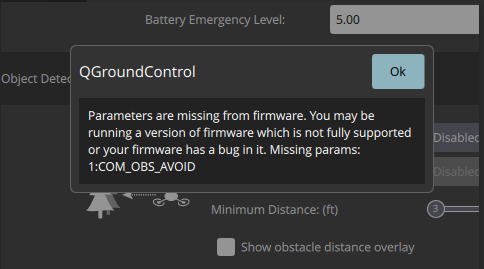

Im still using the PX4 1.15.4 because there is no warning showing there like this . so Im waiting for it to disappear in the next stable version as 1.16.0 and 1.17.x still has this

this is the params I currently used on my drone
I cant see this CAM_TRIG_MAX_CNT in the param list. Do i need to enable this in boardconfig?
