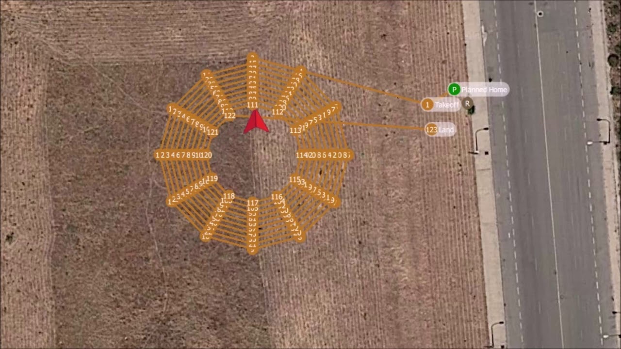

Having experience with ArduCopter and Mission Planner (MP), I decided to try PX4 and QGroundControl (QGC) on a quad. Not having experience with both, I don’t know if features I find in ArduCopter/MP are not present in PX4/QGC or that I cannot find them.
For comparison, this a a mission for ArduCopter/MP (spiral of 10 circles 12 points each), which I read on QGC and saved as a .plan file, adding a poly geofence and doing minor editing:
For capturing previous image, reading on QGC the mission .plan file, I couldn’t zoom in it enough (fly or plan views (waypoints too close)). On plan view, saving missions waypoints as KML, and reading the .kml file on Google Earth, this was obtained:
Strangely, north is pointing right, and the mission appears elevated around 590 m over ground. So I manually edited heights in the .kml file to get this image:
Am I doing something wrong? (Q1 below)

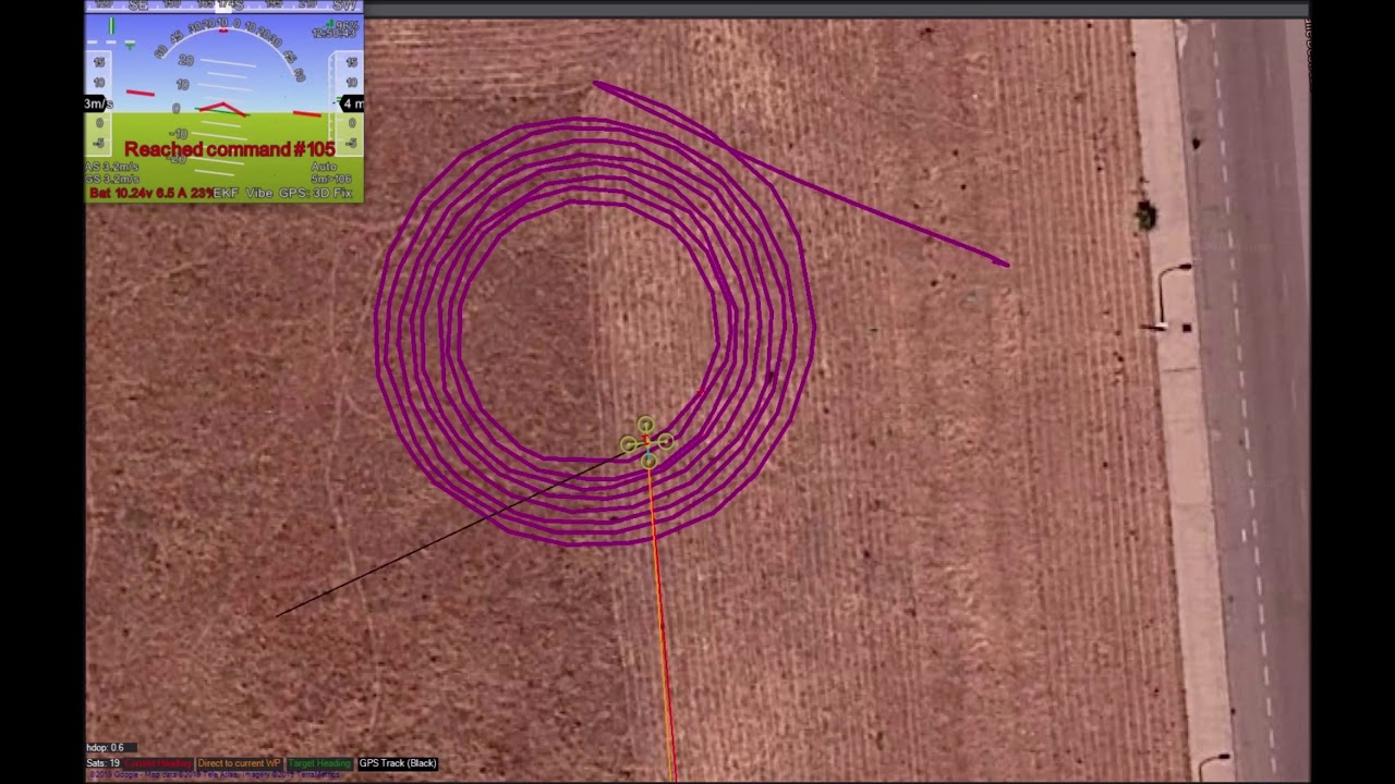

This is the video of the mission on ArduCopter/MP (4K):
I wanted to get an equivalent video of the same mission on PX4/QGC.
As seen, it includes the capture of the .tlog telemetry file on MP, with two nice things:
-the hud can be detached;
-purple trace for the quad trajectory.
This is the video of PX4/QGC/MP (also 4K; QGC running on laptop):
not only with QGC trajectory capture on plan view (zoom in was not enough on fly view), but also on MP (to my surprise, MP read the .tlog file generated by QGC).
So on QGC (compare with MP video part):
-Zoom in was not enough in plan view and specially in fly view (which includes the hud). When adding offline maps I had used the maximum zoom for Google satellite maps (20).
-No quad trajectory line as in MP.
-The quad red figure appears under the waypoints.
-Almost no speech.
How can I get more zoom in in QGC? (Q2 below)
How can I get trajectory, figure over waypoints and more speech on QGC? (Q3 below)

Comparing the real video parts of both videos it is clear that on the PX4 video the quad stops at every waypoint, which makes video too long. I don’t know how to avoid this. Observing this double capture:
amazon1espiral10x12_ROIfarola_wps23
-On the left appears “Unknown” for a ROI (Region Of Interest waypoint). However, it works perfectly as seen on the video.
-I can’t find documented “Hold” and “0 secs” on the right. Unchecking “Hold” on the .plan file on type 16 waypoints

My guess would be that the height of the “Planned Home Position” for the plan is not set correctly. If you loaded from an MP mission that could happen. Check the height in the first item “Mission Start” in the plan view. If it is wrong then relative altitudes for all waypoints will be wrong in the generated KML. This only has an affect on the KML, if you fly it for real it will be fine since then the home position altitude will come from the vehicle.
Yes, this is something that is currently not available.
When you fly the mission you should get a red line which shows you where the vehicle flew. Is that what you are looking for?
Not sure what you mean here. What sort of speech is missing?

Yes, I am reading an MP mission (.waypoints), and save it as a .plan file (I am ready to edit it manually).
This is the mission plan view:
I don’t see what you mean. If I change Planned Home Position Altitude from 592 to 0, the black waypoints rectangles below change to red and then back to black, and the 592 value appears again.
What am I missing for getting a correct .kml file?
BTW, what do the black rectangles below mean? The waypoints are alternatively at 4.5 and 5.5 meters high, and there are four different height rectangles.

Here is the mission with the red line, on the Fly view, after fully replaying flight data (QGC generated .tlog file). All is nice for the capture, but the zoom level is not enough, and is not adjustable (or I don’t see how to change it). Moreover, the waypoints are above everything. For the video capture I chose the Plan view.
While flying it is nice to hear some data, such as battery voltage. For the video it is nice to have the speech sound in adition to the far quad sound. Carrying a bluetooth speaker the speech appears clearly on the recorded video.
