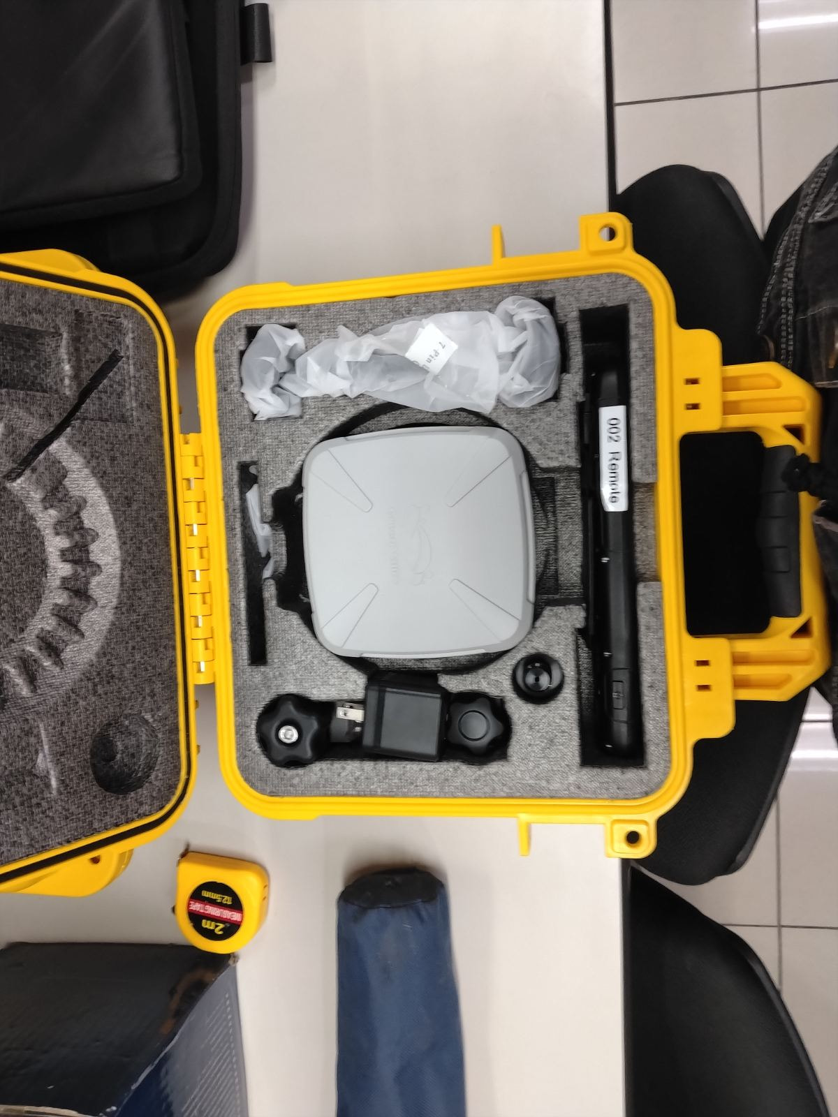

We currently have 2 GreenValley Libase GNSS receiver ( mostly use for LiAir device)
reportLeverArm.pdf (2.7 MB)
can we use this LiBase to connect to Laptop and make it as RTK ground module to feed to SBG via Telemetry radio to achieve RTK correction? if so, how?
anyone have tried this? or any idea?
