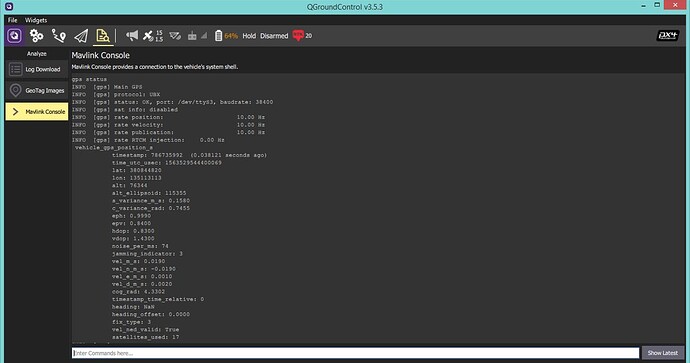

But in my GPS STATUS window I don’t see the horizontal accuracy which is very important.
Is there a way to get it displayed?
Or is there a way to query the Pixhawk 4 in real time?
So you can see the actual accuracy data?
Thank you all for the support.
You can use gps status on the shell and it will print the full details.
Hi @bkueng thank’s for your reply.
Hi attach print screen of GPS status but i not see information about accuracy…
am I wrong anything?
Very thank’s to all
It’s eph (horizontal accuracy in m) and epv (vertical).
