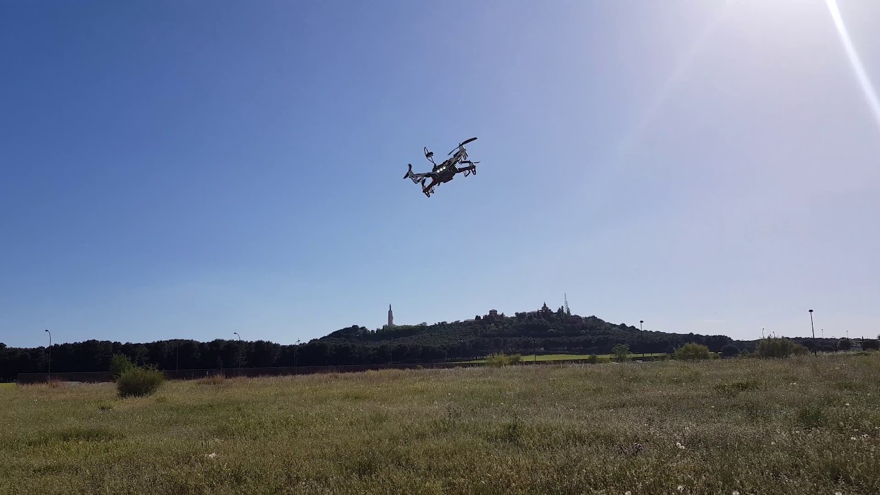

Being new to PX4 (quad), when flying missions I cannot avoid the quad stopping at every waypoint, and don’t know if this happens by design or can be avoided.
These two videos show quad stopping:

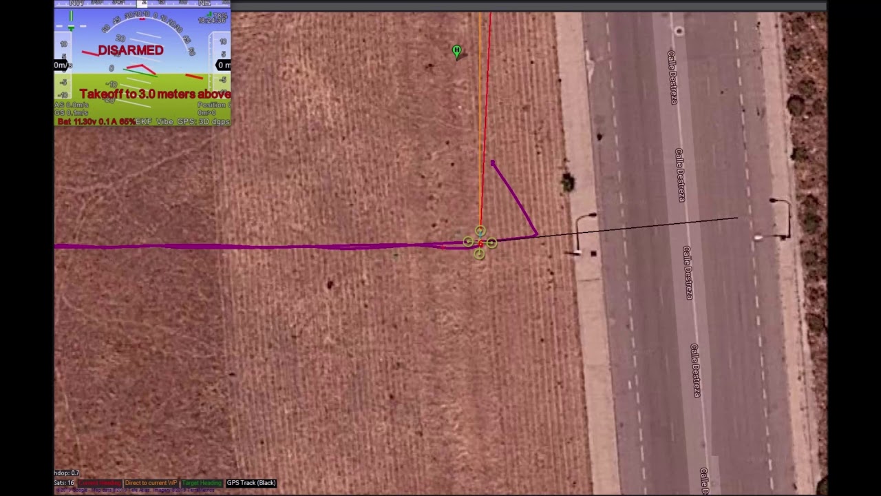

(QGC tlog by MP)
(MP tlog by MP)
The mission consists in a few waypoints with constant latitude on a straight line east to west and then back (quad with constant orientation). On the tlog portion of both videos it can be seen that the roll changes when stopping:
Velocity on quad logs:
It is clear that when the quad travels to the west Vy goes negative and to zero at each waypoint, and when coming back it goes positive and to zero.

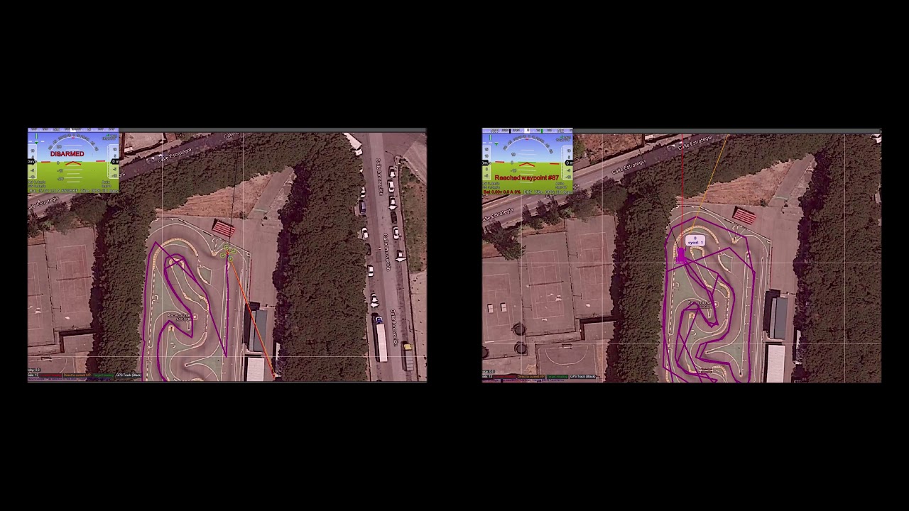

What happens with PX4 on a car?
Observe this (ArduRover):
Obviously, for a rover on a circuit it would be absurd to stop at every waypoint.
