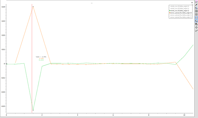

Hi @haumarco, I did this bench test (quite short as you see) and tried turning the drone along the z axis abruptly. This is the result I get and I interpret it like there is no delay between OF and IMU - does it make sense?
~ Nick
yes, possible. you can check sensor_combined, which is the imu topic but at a much higher rate. you can also compare the timestamps with a python script or similar. also make sure to do the other steps i mentioned
