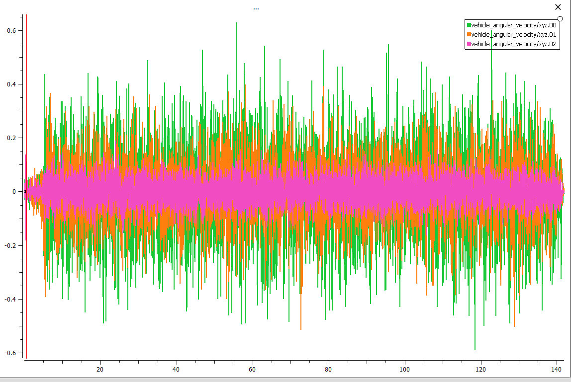

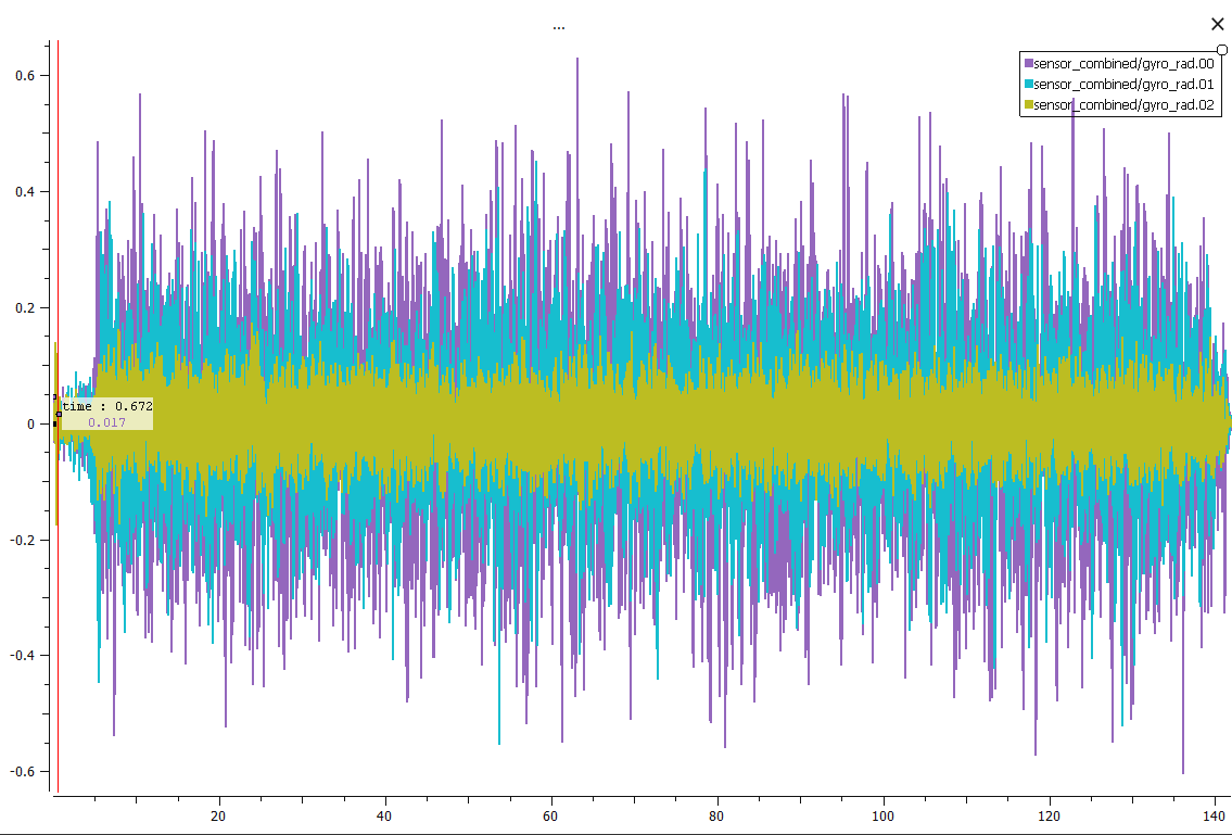

Bad vibration like yours corrupts all IMU data, bad IMU data will corrupt the estimator, and it will eventually cause incorrect position estimates and thrust commands such as yours. Gyro is primarily used for calculating attitude, attitude is used to transform raw accel, if gyro data is bad then vertical acceleration (for example) will be bad. All your flight logs, including your recent log, show strong signs of very bad vibration. Your raw acceleration overlaps, your raw gyro is very noisy, your Acceleration Power Spectral Density plots showed strong yellow energy spread across all frequencies, there isn’t really a narrow band frequency that DNF can filter out. read here for more info. You shouldn’t fly with this many signs of bad vibration.
If you use plotjuggler on your recent flight log and look at vehicle_angular_velocity (post filtered gyro), sensors_combined gyro (raw gyro), the post filtered is just as noisy as the raw data, the default filtering can’t filter out this level of vibration, DNF won’t either.

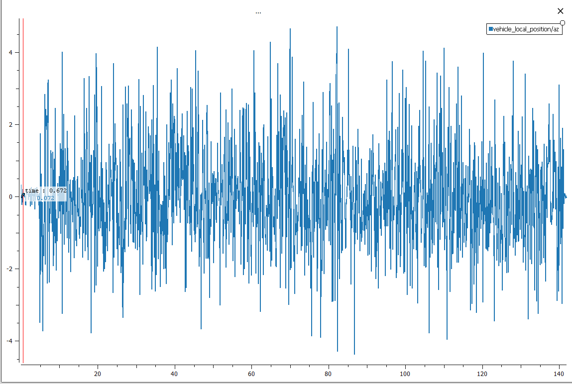

And this plot is what the estimator thinks is the vehicle’s vertical acceleration is (filtered and fused), this isn’t normal where only thrust is commanded or during hold mode, the estimator will eventually react to this. There is likely stable flight initially and then instability later because these errors accumulate over time.

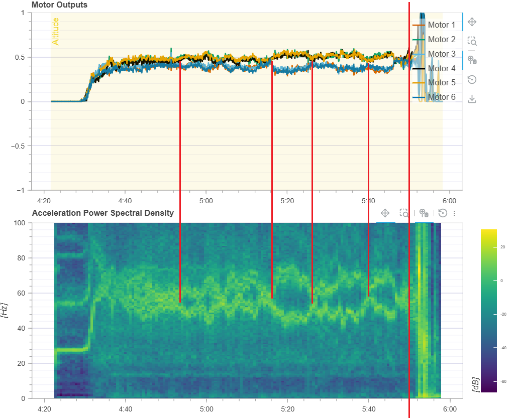

I also think vibration could be the main cause of my problem, but when looking at the Acceleration Power Spectral Density I can see a clear correlation with my Motor Output. Could this mean that the DNF might work in my case?
Both graphs are below, as well as the Flight Review and the link to my posted issue.
