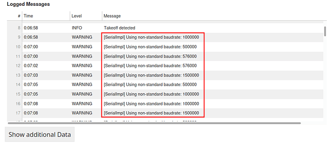

Here is the flight log. You can observe this in open 3D view where you can see the stick input and how the drone reacted during RTL.
One observation,
_stick_yaw.generateYawSetpoint();
& _acceleration_setpoint.xy()
is implemented in update()
loop of auto and descend (line 63) flight task inside the nudging the condition.
In other flight modes the these are implemented in _updateSetpoints()
. Is the frequency of the update less than the _updateSetpoints()
which might explain this?
