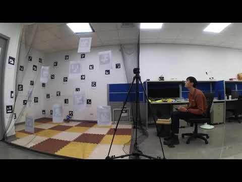

However, I’ve encountered a peculiar problem when switching to altitude or position control modes. My commands seem to be delayed or even stuck, causing the drone to rapidly accelerate and crash after a few seconds when the control signal is finally transmitted.

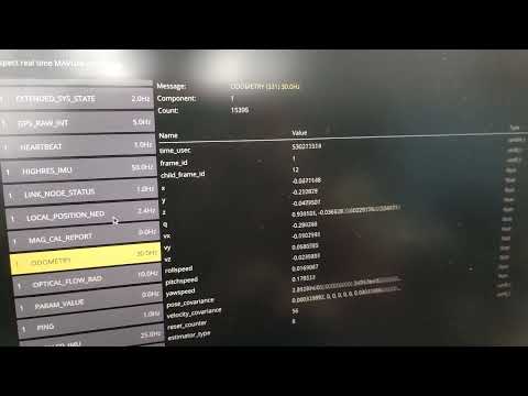

In addition, I’ve noticed that the odometry topic appears to be functioning normally at 30Hz. However, the position NED topic occasionally drops to 0 before returning to its normal state after a few seconds. I am uncertain if this is related to the issue I am facing.

failure:
stange topic behavior: (local_position_ned and odometries not the same)
