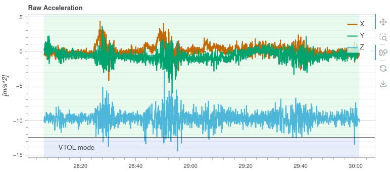

I’m flying a lift + cruise VTOL with a total mass of about 16 kg. It features 8 hover motors and 2 pusher motors for forward flight, all controlled via UAVCAN v0. The flight controller is running a custom version of the latest stable release, and everything has been tuning quite nicely for basic hover and transition maneuvers.
The Issue:

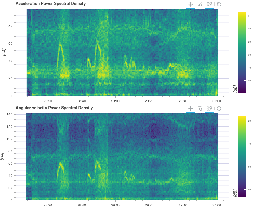

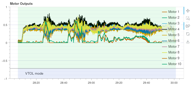

As shown on the pictures, I’m seeing quite noticeable noise/oscillations on the hover motor outputs. I am not entirely certain but I suspect this is causing the ESCs to run quite hot (up to 70-80°C after 5 minutes of hover). The vehicle handles the flights stably, but I’d like to address this before I destroy an ESC and crash. The PX4 vibration metric is always in the green.
What I’ve Tried So Far:
Reduced the MC rate controller D-gain and P-gain for roll and pitch axes. This did not help to mitigate the noise. Further, I am using a slew rate limit, which also does not help much due to the low amplitude of the noise. Increasing it further would mean to trade control authority.

Just as example: Noisy roll angle setpoint

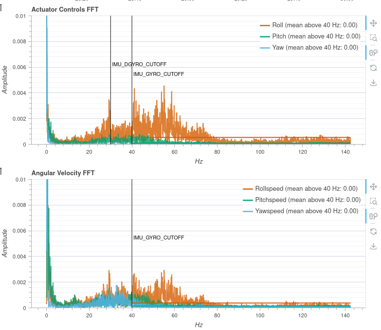

Have you tried reducing the filter bandwidth cutoffs?
And have you tried reducing the D gain quite a bit? I think even setting it to 0 might be worth a (careful) try. @dakejahl that’s what you said, right?

Just wanted to support Julian’s advice. We saw similar traces when we first set up our vehicles. The default filter (something like 50 Hz cutoff) was way too high. For your size, you are likely going to want something along the lines of 5-10 Hz depending on the speed of your inner-loop controllers.
