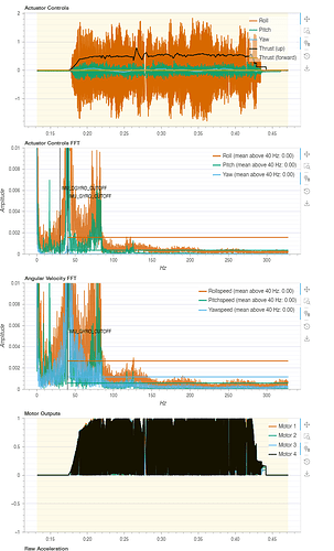

I have now gotten stuck in a problem where my drone is oscillating / vibrating. Firstly i though it could be vibrations from the motors going into my pixhawk and ruining the sensor values / regulator. Therefore i mounted it on a anti-vibration rubber mount, this however did not improve the performance. This made me look more into logging and activated more logging options and follow the “vibration isolation” and “Log Analysis using Flight review” guides from PX4. I can clearly see that the drone is vibrating more than it should from the guides. However i can see some weird motor commands where the motor outputs goes between 0-100 continuously, shown in this log:

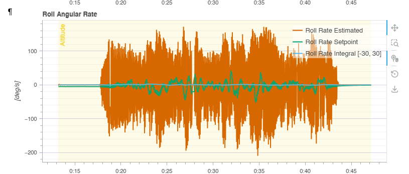

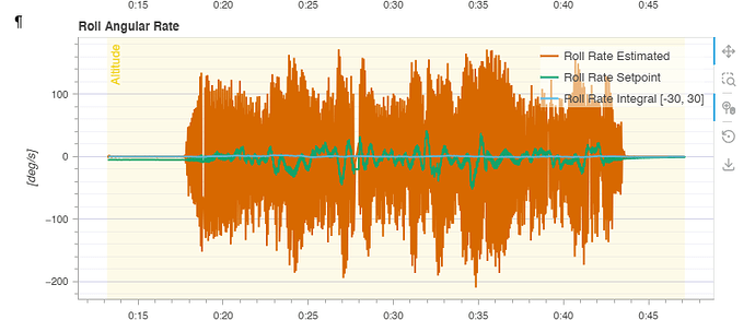

As seen in the logs you have extremly high vibbrations, You’re having ±100 deg/s in noise in the estimated rates from the gyro. It’s no wonder it can’t regulate correctly
You can see it becoming a bad loop, noisy input => noisy output commands => even more noisy input, etc. The motor commands are going from 0-100-0% very rapidly
You’ve included high rate logging which is good, that means you can se at what frequencies you are having problems.
Seems like you have a 2 bladed prop which makes the 2nd harmonic at ~40Hz the worst.
You’re filtering parameters are sub optimal since you have IMU_GYRO_CUTOFF = 40Hz so all the noise is going through, only the higher harmonics are attenuated.
