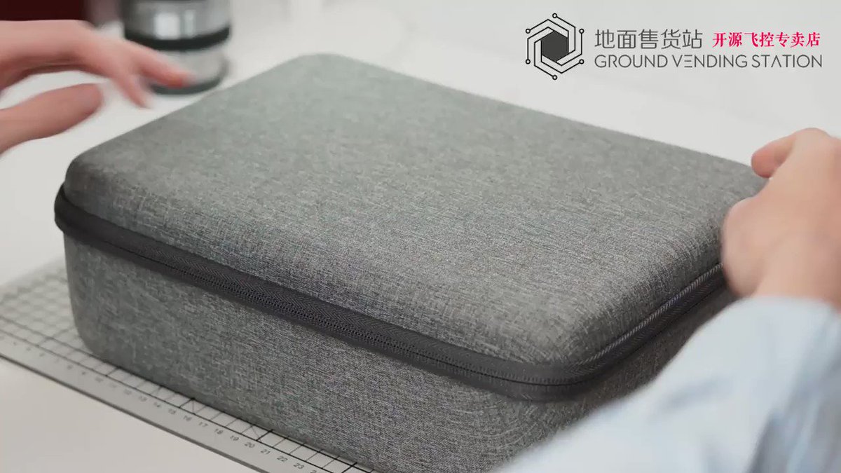

Skydroid H16 Unboxing Showcase

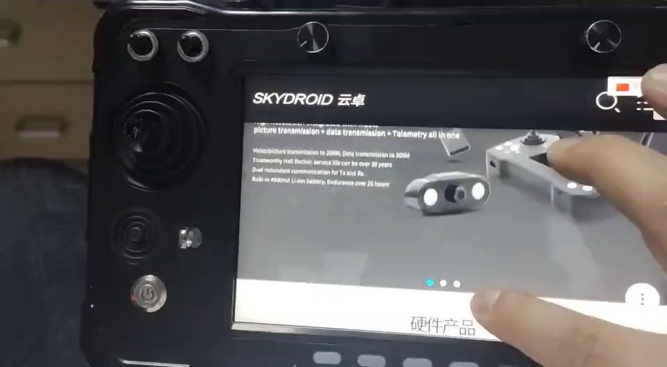

There is a APP called “H16Tool” on the controller, to adjust the channels and bind with airunit.
You can install any non-Google Mobile Services dependent Android APP on it, most of GCS APP is no problem.
