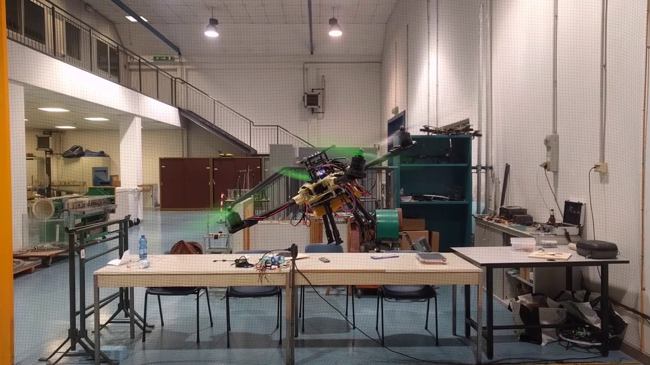

I would like to check if there is any interest in using the passthrough mixer to override the regular mixer behaviour and implement custom mixers.
This is motivated by:
  • research purposes: test new mixer concepts different from the multirotor mixer already implemented;
  • educational purposes, i.e., how does the mixer work under the hood?
As an example, in our research lab we have developed a tilt-arm quadrotor, which in addition to the four motors has four servos to let the arms tilt independently from each other (thus we have 4+4 control variables):
The control architecture we developed includes a nonlinear mixer which computes the eight control variables (four motors PWM and four servo angles) based on the required forces and moments.
Since the PX4 mixing architecture only allows for a linear mixer (with offsets) to be implemented, we employed a passthrough mixer so as to be able to directly pilot the actuators, thus bypassing the multirotor mixing mechanism.
The actual nonlinear mixer, together with the controller, was implemented in a module upstream the passthrough mixer.
This solution works, however it breaks the interface established at the level of control group:
the idea of control group is to publish normalized forces and moments (to the actuator_controls_X topic where X is usually 0) which are then fed to the mixer.
But when using a passthrough mixer, one has to publish actuator demands on the same topic. The result is that the mixing system might misinterpret the request coming from the higher level (e.g., in control group #0 the fourth input is interpreted as the throttle, but if using a passthrough mixer this is actually the demand to motor#4).

Possible solutions:
  • introduce some structure in the architecture: define a new custom mixer class at the same level of the multirotor mixer. this has the advantage of not disrupting the interface at the mixer input, and it avoids using the passthrough mixer; however it requires handling separately controller and mixer.
  • if one wants to keep the architecture as unstructured as possible (i.e. keep controller and custom mixer in the same module, and use a passthrough mixer - this makes sense in a research framework), one idea could be to add a new control group (say, associated with topic actuator_controls_X) explicitly dedicated to the usage of the passthrough mixer (i.e. the actuator demands are published on actuator_controls_X) while still publishing the required forces/moments on actuator_controls_0, though this information would not be used for control, rather for monitoring and logging purposes. This would preserve the role of actuator_controls_0 as the channel where the information on forces/moments runs.

@Jarvis2991 I defined a custom module implementing my own controller and mixing system. The outputs of such mixer are the control actions for the 4 motors and 4 servos. I publish them respectively on the uorb topics actuator_controls_0 and actuator_controls_1.
Then, I defined a .main.mix file as described here:
https://dev.px4.io/master/en/concept/mixing.html#simple-mixer
with one Simple mixer element for each of the 4+4 actuators.
That is, the mixer basically passes through the four motor control actions to MAIN outputs 1-4, and the four servo control actions to MAIN outputs 5-8.

@Pbecchi actually our custom mixer is running on the autopilot. In this way the NuttX real time operating system running onboard guarantees execution of the code at the desired rate. Further, running the code on the autopilot avoids the intrinsic lag associated with the communication channel, which unavoidably leads to degradation of performance of the feedback control loop.
