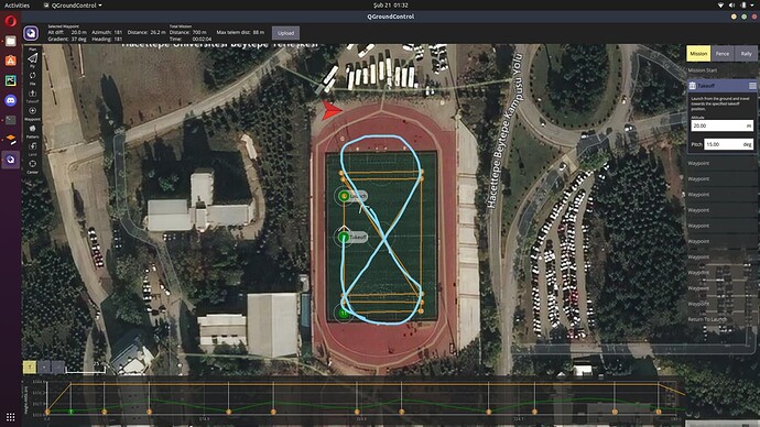

I’m trying to do a autonomous mission with MAVSDK-Python.I’m using PX4 Plane. When I’m trying to go to a waypoint with a function which uses goto_location() function,Plane starts to loiter around that waypoint. What causes this problem?
@Erush I don’t think this is a “problem” since this is the expected behavior - since fixedwings cannot “stop”, it considers GOTO waypoints as a loiter waypoint with the default loiter radius.

I have several waypoints which plane have to pass through. Like an 8 pattern. I tried to set up a mission like it from code but it didn’t worked like I expected either.
@Erush Your fly view(first image) shows that the mission was not transfered to the vehicle and it is just loitering around the takeoff waypoint.
Try planning the mission with QGC and fly mission and see if the vehicle is able to fly the full mission
It does not fly mission properly. It goes to next waypoint before going to the one before it.
@Erush Your fly view shows that the vehicle is orbiting a “Oribit” waypoint and seems like it is not in mission mode but maybe “hold” mode.
Can you share either a log of the flight or the mission file?

Are you sure you uploaded the mission to the vehicle? Your mission was missing a landing pattern and therefore I had to add it.
How can I make it go like this? It is not going to waypoints like I expected. Even in your plan it does not go even close to waypoints on the upper side.
@Erush It is because your waypoints are too close, and the waypoints are “reached” since you are within distance to the waypoint of the acceptance radius.
Try putting the waypoints more further apart. The simulated vehicle cannot turn as tight as you have drawn in the picture
