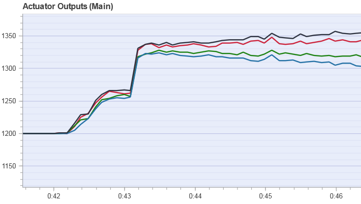

I have same issue with my DIY drone. When I armed, there is no problem, all motors spin with my PWM_MIN value (1100). But if I give max throttle; 2 motors are spinning slowly and stopping, 2 motors are spin higher. What should I do? Is setting higher the PWM_MIN value right solution for that issue?
Thanks!
Here is the difference:
Screenshot from 2021-03-26 23-54-14|690x387

Could be that your drone is just trying to correct it’s position (roll right in the image you attached). What fly mode are you using?
Are all the sensor correctly calibrated? Have you got a good GPS signal? (in case of Position mode)
A motor never sould stop once is armed, so could be that PWM_MIN value need to be at 1150 or somethink like that.

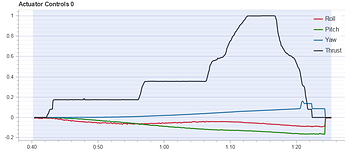

Can you share any flight log?

Hi @Retro-meb, thank you for answering
- I am sure that ESCs are correctly calibrated.
- I think main problem is that. You can see my ulg file ( https://drive.google.com/file/d/1z2tq9uKMXfgN2VqzjLdvdQTuQvynLKB7/view?usp=sharing ) . I am using stabilize mode for fix the problem. I have no props on my air. I just wanted to see servo outputs without props.
- There is no difference between arm with GPS and without GPS, servo outputs same. I really calibrated sensors carefully but there is nothing change.

At the “Actuator Outputs” chart I can’t see any motor stop and the motor lines aren’t very distant between them.
It’s true that the output PWM is not exactly equal, but in my opinion, it is because from the very beginning the auto-pilot feels that the roll and pitch angle is not 0 and is trying to correct it.
And as the time passes and it can correct the pitch and roll, it tries to correct it more abruptly.
