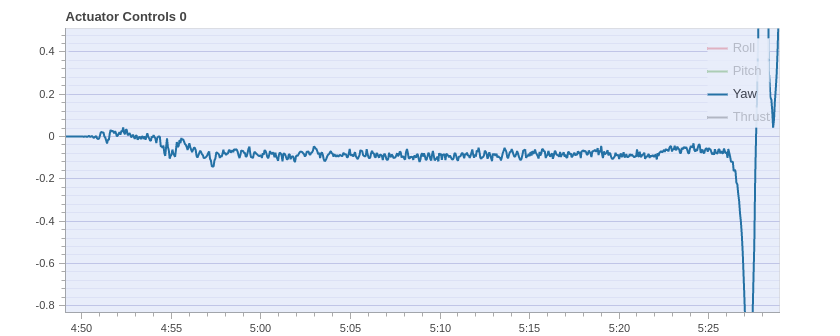

I searched the forum to see if anyone had experienced something like this before, but I couldn’t find it. If there is another topic, please excuse me. I’ve had problems with the engine before and I’ve solved them. I started flying and successfully performed the first flight. On the second flight, my plan was to do straight back and forth (in stabilized mode) I did it forward, but on the way back, the drone awkwardly somersaulted and crashed. If my observations are correct, one of the motors turned off in midair. I’ll be happy if you can help me.

To me it looks like the vehicle just lacks of yaw authority. During deceleration, the vehicle did climb due to its lift and the yaw authority wasn’t enough to keep the vehicle’s heading in place.
Seeing this, the pilot reduced thrust to 0, crashing the drone (you can clearly see in the 3D view that the drone first started to loose yaw and then flipped when the throttle stick was at 0: 3D View - Flight Review).

As shown on the plot attached, you can see that the done is constantly fighting a yaw disturbance (most likely created by a misalignment of the rotors).
It’s fine when there is enough motor range to control the roll/pitch of the drone, but when the mixer needs more roll/pitch torque, the yaw actuation is deprioritized and the drone starts to rotate due to the constant disturbance.
