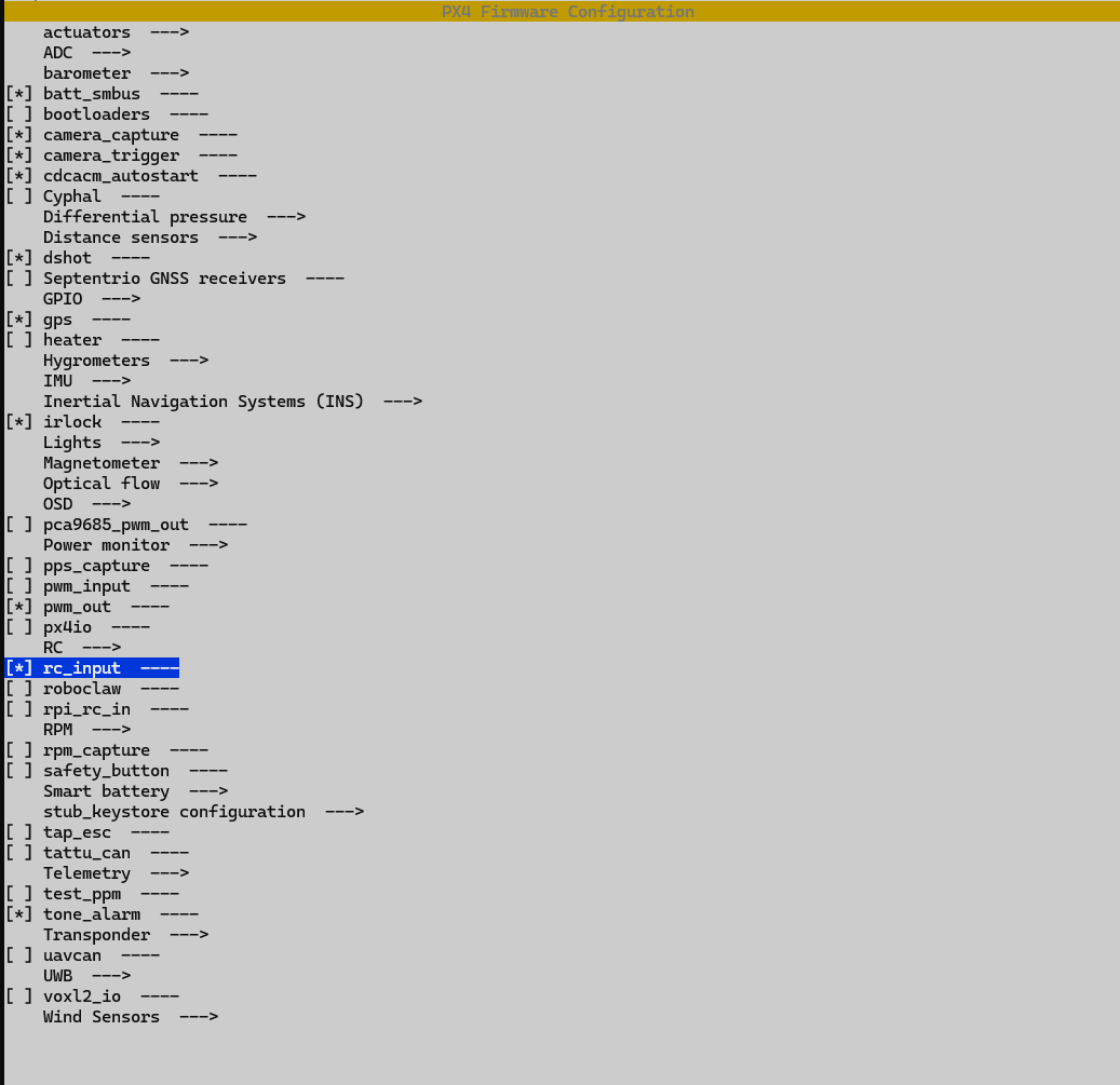

Hey! @XJH-Jorhai I did follow the Mavlink - ExpressLRS guide, but I had no luck. May I know which Px4 version are you running, and the parameter lists that you changed, as the Nxtpx4 is using RCin as primary causing some confusion on configuring in Mav / telem ports.Also am running Px4 - ver 15.1. I have upgraded the radio and the rx.
Hey! @carbon
First you can try connecting your Rx to another port such as SEL_TEL1 instead of SEL_RC and try again
If it still not working, follow to disable the rc_input
By NxtPX4v2’s web.It uses hkust_nxt-dual target.
So after setting up Px4 compiling enviroment, run
make hkust_nxt-dual boardconfig
you can go on configuring the firmware
In drivers you can find an
[*]rc_input
roll down to it and enter
the * should be removed and now the firmware that you compiled will not using common rc
after configuring those , save and quit then run
make hkust_nxt-dual
if everything goes well you can get an .PX4 in
PX4-Autopilot/build/hkust_nxt-dual_default/hkust_nxt-dual_default.px4
uses QGC to upgrade your firmware into your NxtPx4

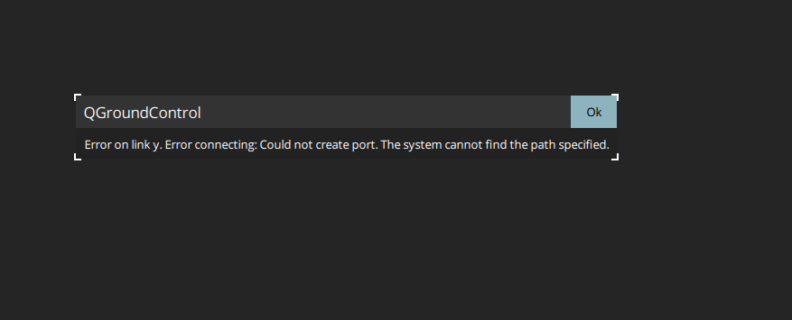

Okay, I did the required settings but I am still not able to get the telemetry data stream to QGC.

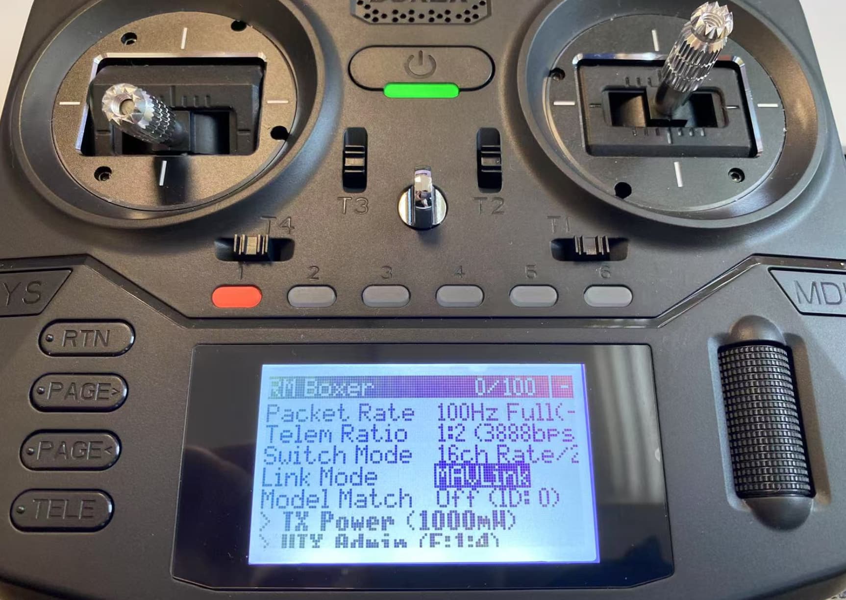

@carbon
Check if you have switched both the TX and RX to MAVLink mode.
For me, I’m using the RadioMaster Boxer, and the configuration in the ELRS script looks like this:
If you have bound your RX, you should be able to access its configuration board, which also has a “Link Mode” option.(Sorry for not providing the image, my drone is currently out of access.)
M
If it’s not set to MAVLink mode, turn it to MAVLink mode and try again.
Also, have you had success connecting your TX through Wi-Fi?
Hey I have the WIFI from the Transmitter showing up and also both the RX and TX are streaming in Mavlink and am using Px4 version 1.15.4 - but we are not able to establish the connection between the radio and the GCS (Qground contorl). On the fimrware side we are not able to enable SER_TELx_BAUD - as in our case SER_TEL1_BAUD is not showing when searching for this. Morever we have connected the radio to TELEM1(UART2) instead of the radio port.
Configure MAVLink with MAV_0_CONFIG to TELEM1
Maybe this step first
If has been changed to telem1 but no _BAUD can be found
