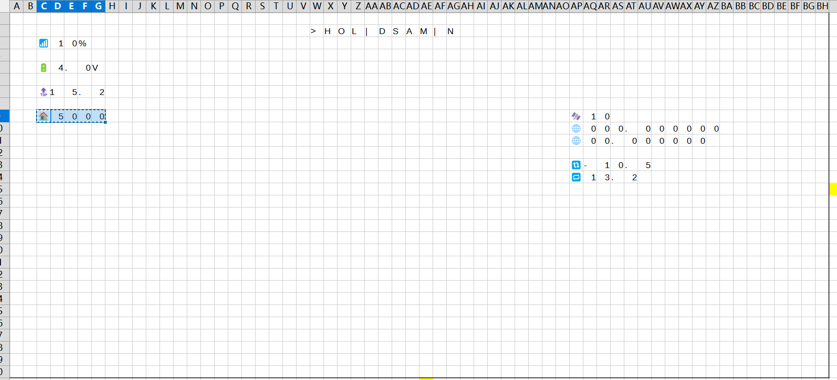

I have analyzed the MSPOSD drawing process of the latest betalight.
[image]
If you want to draw the pitch in OSD, such like in the picture above.
The complete data flow is as below. itās base on subcmd in the message[5].
24 4D 3E 01 B6 00 B7 // Release the display aā¦

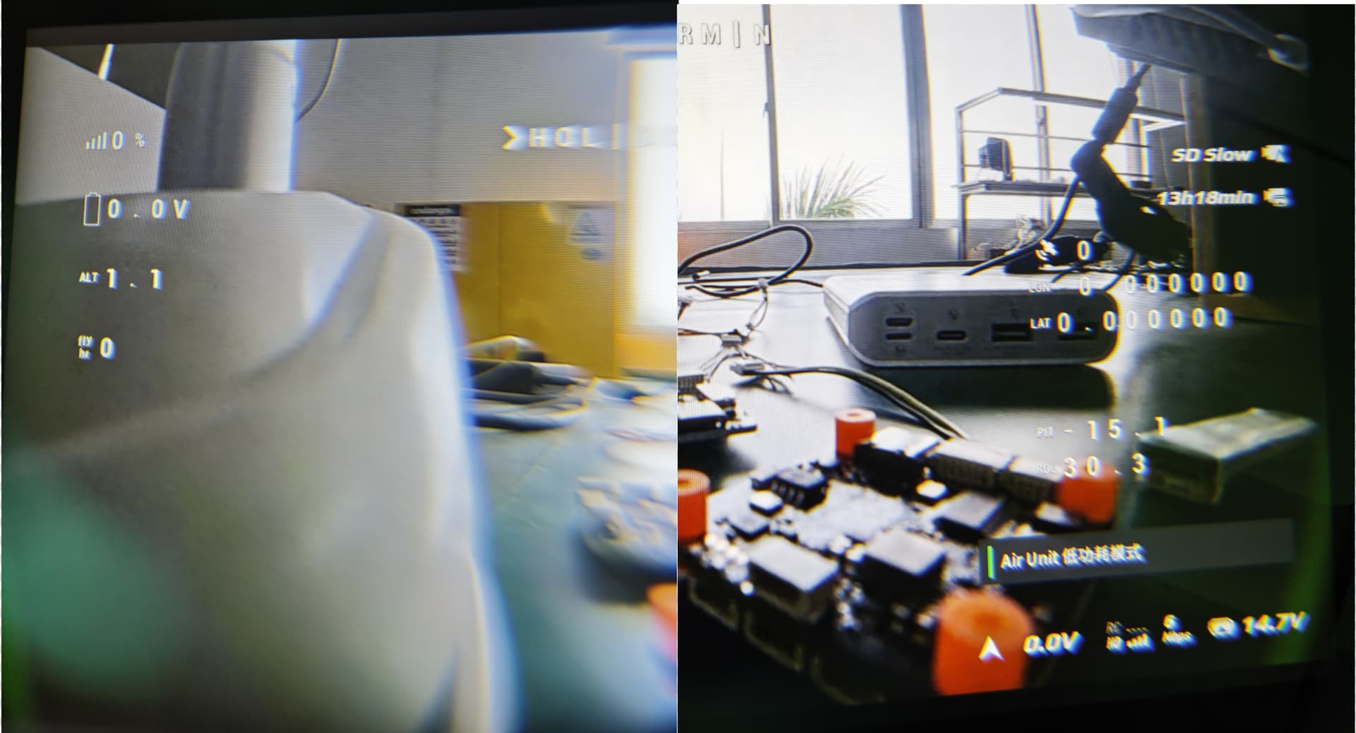

Tested on DJI O3 Airunit and itās OK ļ¼2025-04-07ļ¼

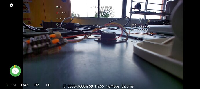

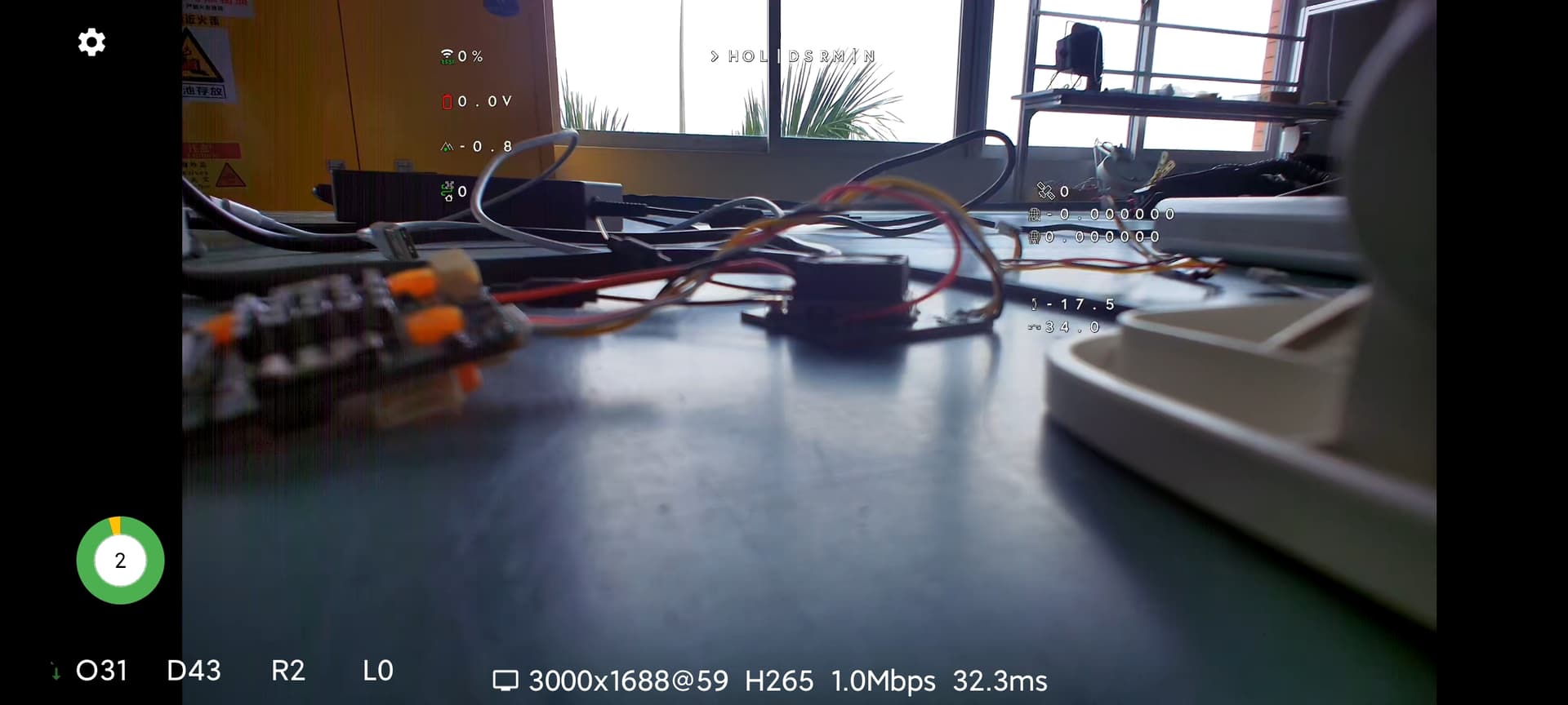

I have completed the modification of MSPOSD function
The final rendering effect is as bellow:
The current OSD can already cover a lot usage scenarios. So, I have opened PR.
If there have any suggestions or modifications, I would be like to continue following up
