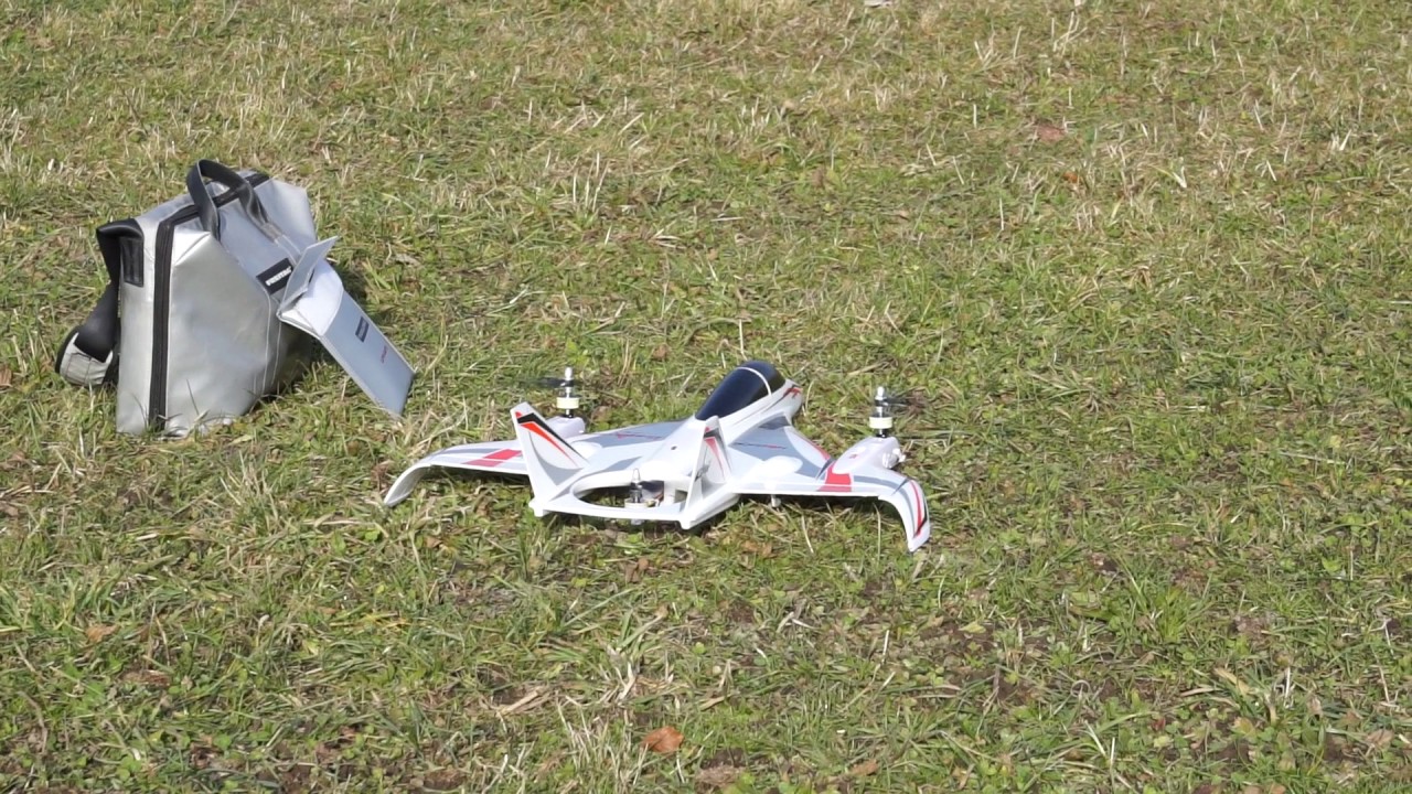

@PKocmoud: we put a Pixfalcon in it: http://px4.io/portfolio/e-flite-convergence/

Support for E-flite Convergence is merged and available on master (Developer Build)
I have my PixFalcon plugged in. I don’t see the Convergence airframe list anywhere. How do I get to ā€œflash the latest ā€œDeveloperā€ version of PX4 and select the Convergence airframeā€?
@ldsanders2807 The developer build you find when you flash the firmware and select ā€œAdvanced settingsā€ (screenshot 1)
After flashing, please restart QGC. You should then find the E-flite Convergence in the group VTOL Tiltrotor (screenshot 2). Select that and press ā€œApply and Restartā€ (top right)
@AndreasAntener: That’s the info I needed. Thanks! What telemetry module do you suggest? And a suggestion on the digital airspeed sensor. I’m going to get my feet wet by installing the PixFalcon into my Convergence frame first. Then move on to my larger saucer shaped frame. This is going to be fun!
@ldsanders2807 I just want to mention first that the E-flite Convergence config doesn’t require an airspeed sensor. For later I’d recommend the voltage corrected ones from AUAV: http://auav.com/ (sorry it seems I can’t get the direct product link but you’ll find it under ā€œSensorsā€). If you plan on using that with the Pixfalcon you’ll need to modify the cables and get an I2C splitter on the bus.

@AndreasAntener Making some progress with the Falcon/Convergence. I finally got it to arm. :slight_smile: And, Servos do need an external BEC. Do the elevons move in the same way as the Convergence FC? Meaning, in hover mode, the control surfaces do not move. In Forward flight, they do. I will do some more testing on this next item. But, when moving some combination of the agility/acro switch and transition switch, the transmitter no longer has control of the motors. In this mode, the transmitter’s motor kill switch does not function. Has anyone experienced this?
https://item.taobao.com/item.htm?spm=2013.1.w4004-6851348497.28.tBmK4t&id=538252549678
BEC: sorry for not mentioning that on the build log, that’s one of these things that’s really natural for me but not so obvious otherwise… :slight_smile:
The control surfaces always move. They also help in wind when in multirotor mode.
I’m not familiar with the problem you describe. It would be helpful if you could find out how to reproduce that exactly.
