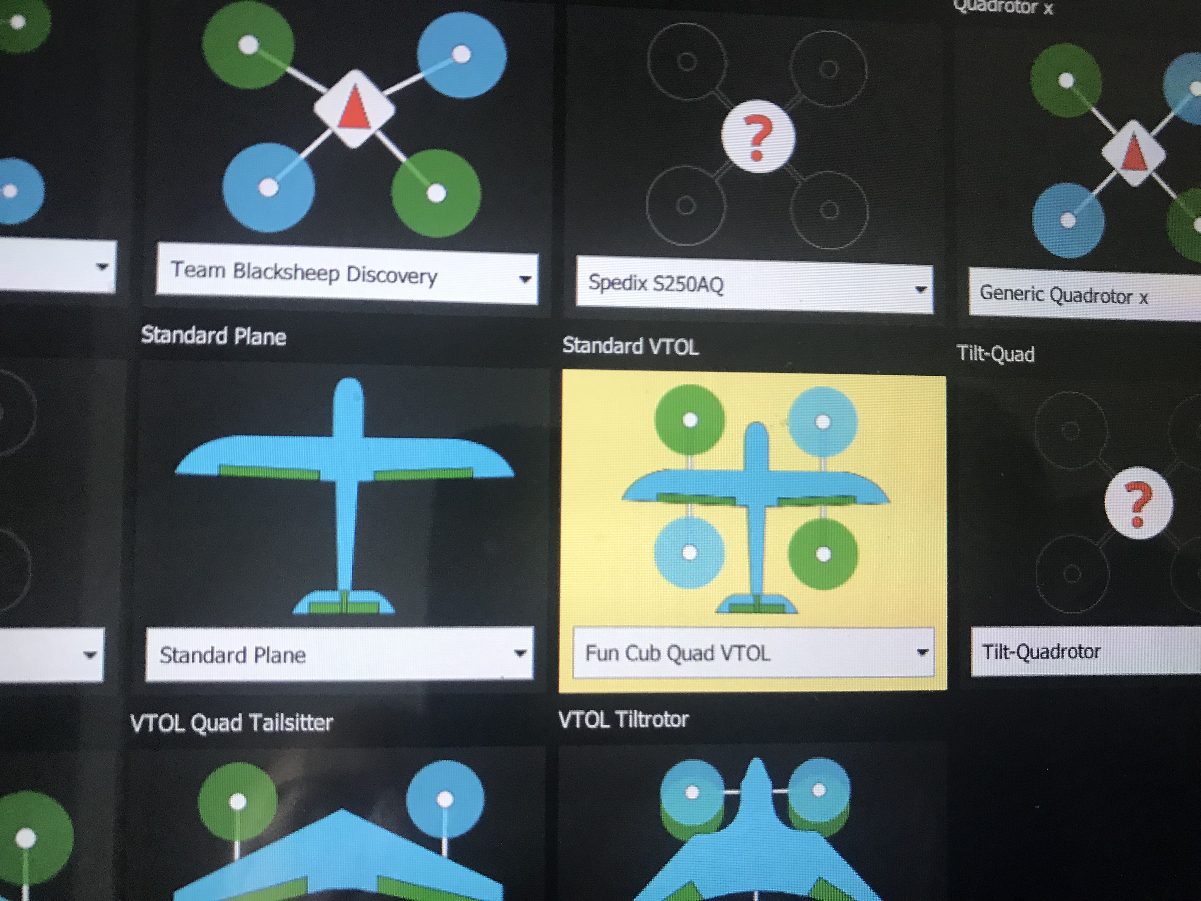

Pixhawk 4 - can’t get the servos (control surfaces) to activate. I have a 6 channel Spektrum DX6 and proper flight modes are working on the three position switch. Transition out of multirotor works but no controls surfaces in forward flight mode.
I think I’m not understanding the “pass through” and how to set up aux channels. I have read through all the documentation, still can figure it out. Help please :slight_smile:

HI Rollys
Here is the info you requested.
Qground 3.5.2
Firmware version 1.9.0
Standard VTOL
Generic Quadplane VTOL
Hobbywing 4 in 1 40amp esc’s
(NOTE: I have been flying this aircraft in quadX mode (just the lifting motors) and it flies great. Wings are offset 30degrees to the motors, and in 30degree pitch forward the vehicle is flying fully on the wings with minimal thrust from the lifting motors. Now want to add control surfaces and forward thrust motors for the forward flight mode.)
Custom Boxwing… Ailerons on lower front wing(outboard sections) and Elevators rear wing (center)

  • Try changing SYS_AUTOSTART = 13005

Tried changing the autostart to 13005 and followed the post #2 procedures. No luck no activities on the servos.
