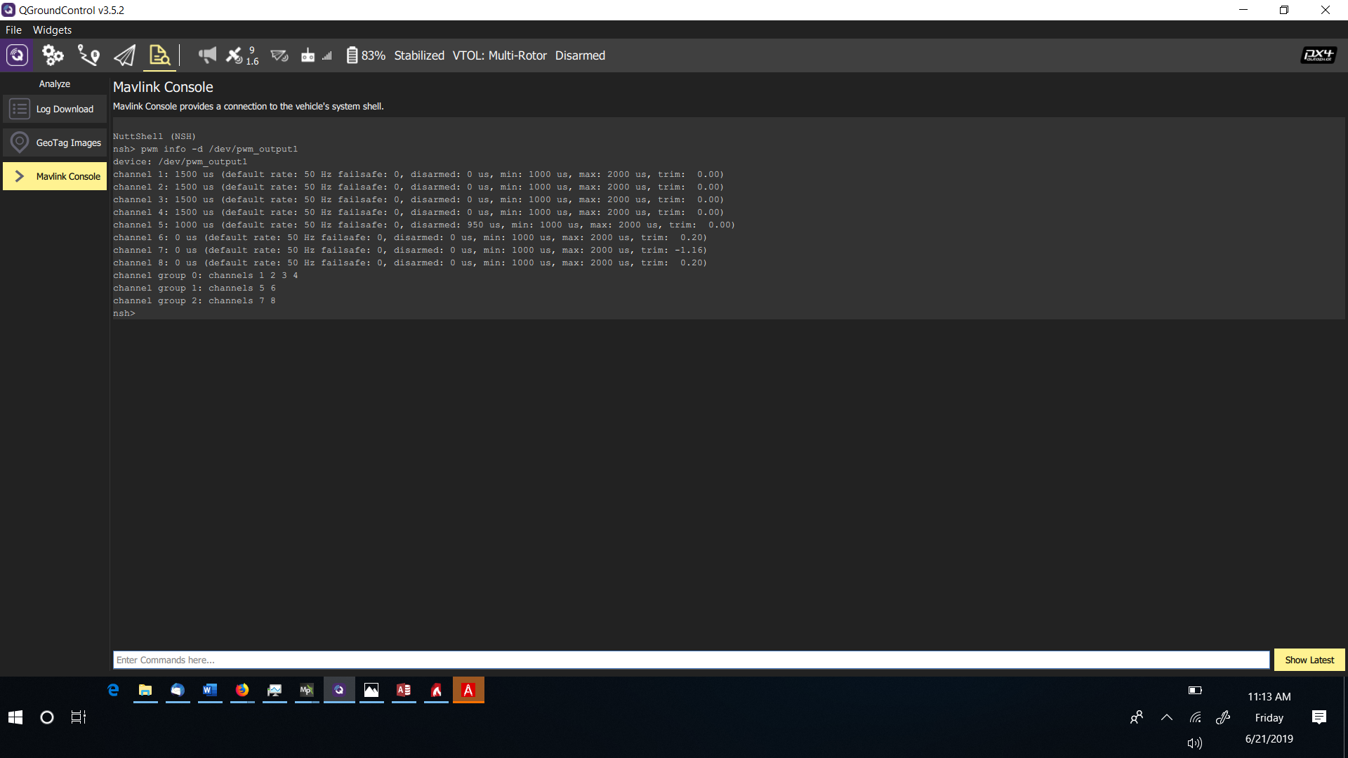

Let’s check the PWM outputs of the AUX: please enter in the console:
pwm info -d /dev/pwm_output1
and share a screenshot.

Below is the screen shot for the pmw outputs…

Sorry, forgot to specify that you should enter the command while you are encountering the wrong behaviour of the motor, so while you have the vehicle armed, the throttle stick at zero and not in transition mode.

New screenshots uploaded:
First is while the vehicle is armed…hover motors spinning at idle, but FW motor at full RPM.
Second is after disarming the vehicle… hover motors stop but the FW motor continues at full RPM until unplugged.

The PWM signal of AUX5 is at an correct value of 1000, which is the setting for no rpm for a normal ESC. It seems to me as though your ESC is calibrated wrongly, as in your case it goes to full throttle instead. If the calibration over px4 does not help you should proceed with the steps explained in the ESC manual for calibration using a RC ( normal procedure is to plug in battery with throttle stick at max, then go to min and max again I think, but check that).
If you have an other ESC close by just give it a shot with that one I’d recommend.
