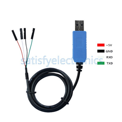

I’ve been using a simple USB-UART cable like this one:
The header cable connection is simply swapped with a compatible connector to whatever UART port you have on the PX4 board you’re using.
