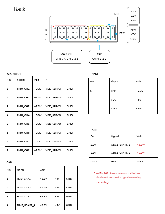

Hi gentleman, i would like know if it is possible command (on-off) an external buzzer (i.e. Viìfly 2) via servo port (i.e n°5) as a landing gear (up and down) for a fixed wing?
What’s the interface to the external buzzer? PWM or the frequency to make it buzz?
Dear Julian , it can be connected as pwm . Take a look at the picture.
In that case it should be possible. I’m not sure if I would use the landing gear functionality or just use Aux 1 or Aux 2, they are usually forwarded in the mixer for such things.

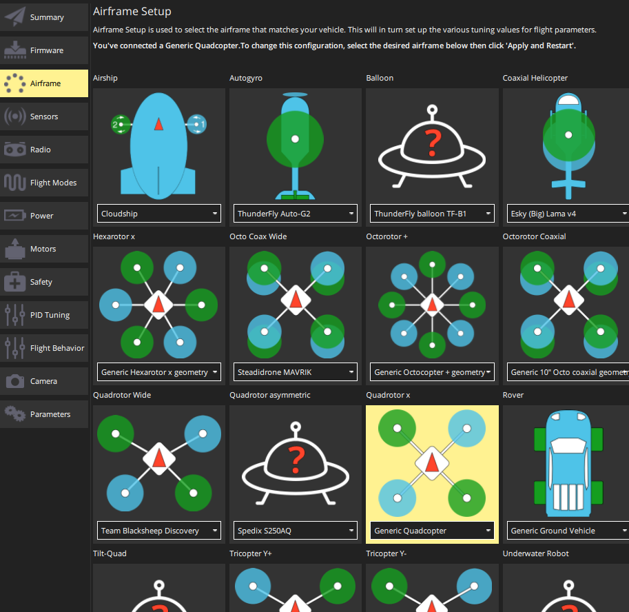

Which model are you using? What is your param SYS_AUTOSTART?
Hi Julian, model is a quadcopter setted as dji fw450. the sys_autostart parameter is 4001

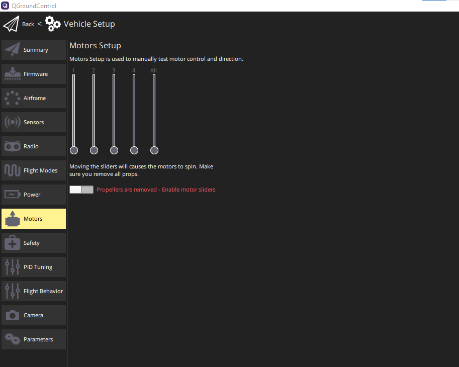

Can you configure Aux 1/2 in the actuators tab in QGC?
Dear julian, seems that i have not tab related actuators!
How can i activete it?
Please take a look below:
@bkueng any tips how to use Aux with 4001 on v1.13?
The quad_x mixer sets AUX1 Passthrough on output 5. So you can assign an RC switch to AUX1 to test and use it.
