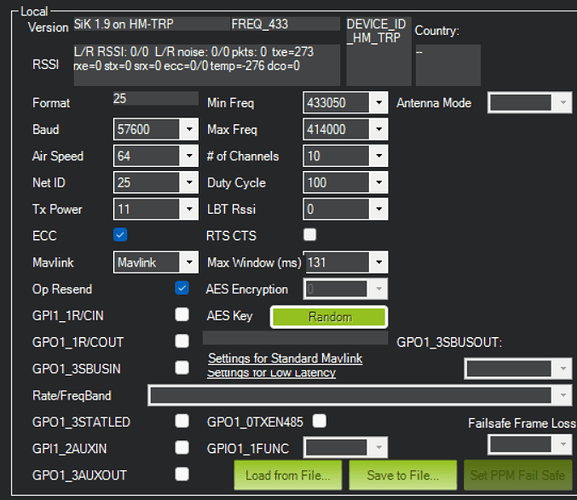

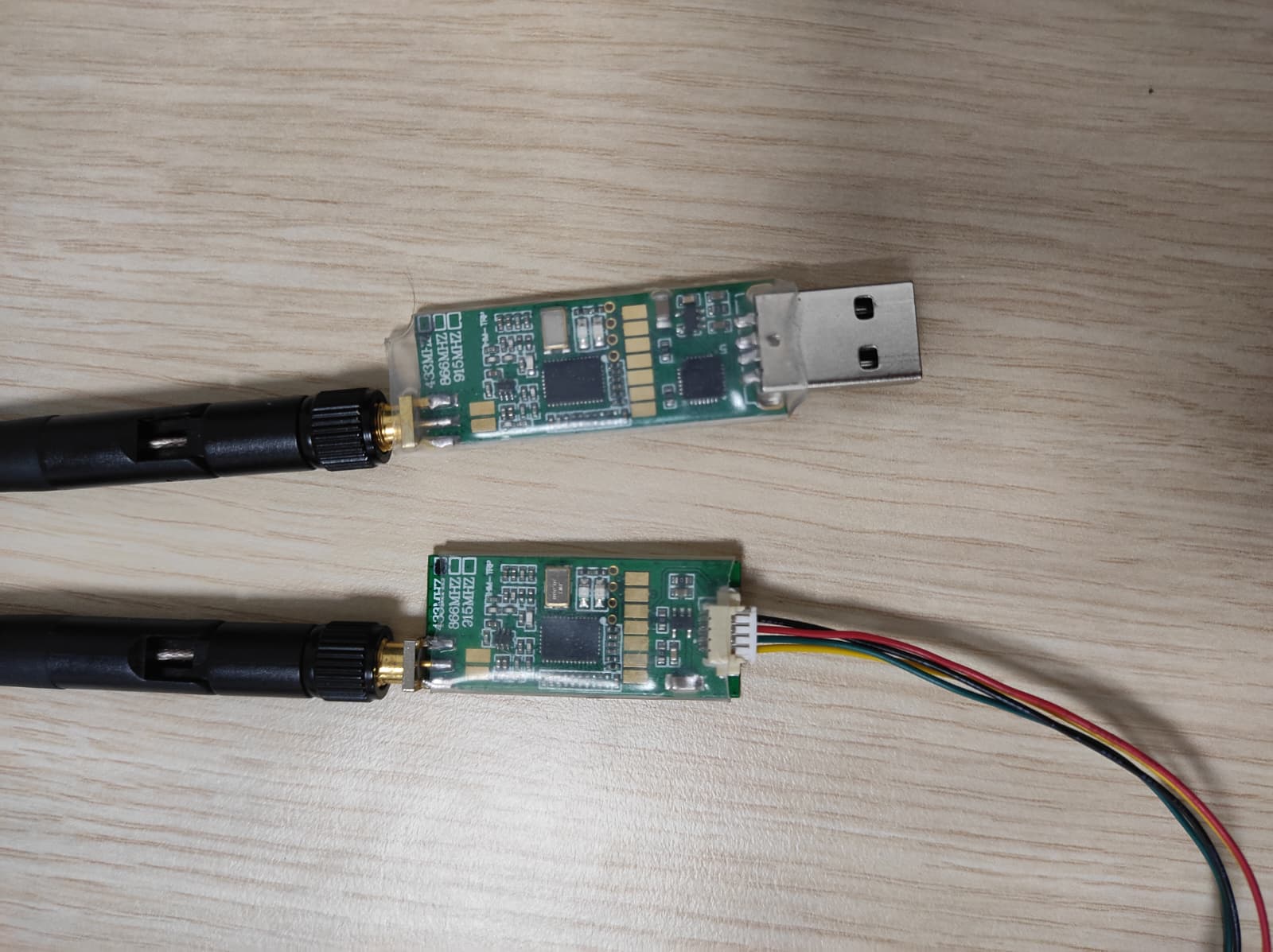

I’m having trouble binding my YRRC 433 MHz SiK telemetry radios (as shown in the pictures). No matter what I try, the air and ground modules don’t match successfully.
Here’s what I’ve done so far:
Configured both the air and ground modules (air module connected via FTDI USB cable) using Mission Planner and CoolTerm, making sure all parameters such as Net ID, frequency, and air speed matched on both sides — following the steps from this guide:
https://ardupilot.org/rover/docs/common-3dr-radio-advanced-configuration-and-technical-information.html
Upgraded both telemetry modules from SiK 1.9 on HM-TRP to RFD SiK 2.0 on HM_TRP, then adjusted parameters again as before. When that didn’t work, I reverted back to SiK 1.9 on HM-TRP firmware.

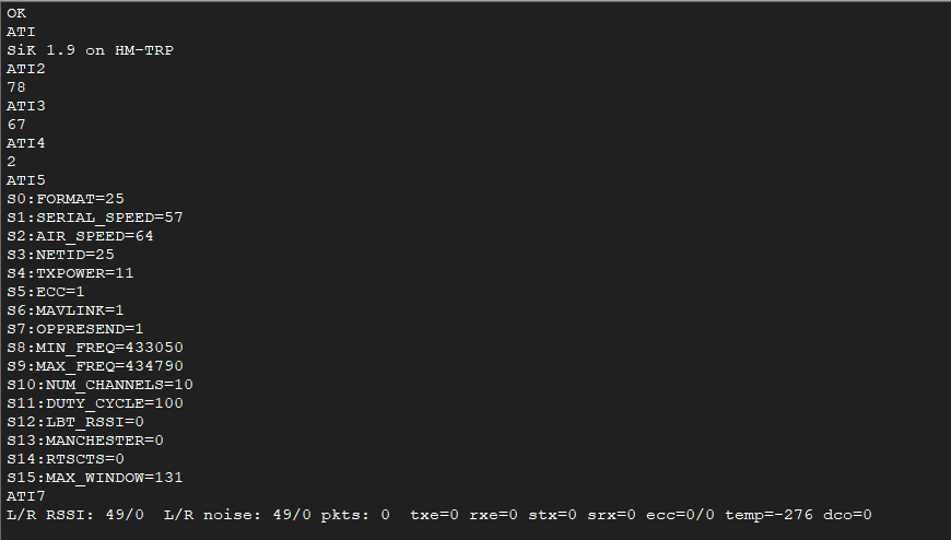

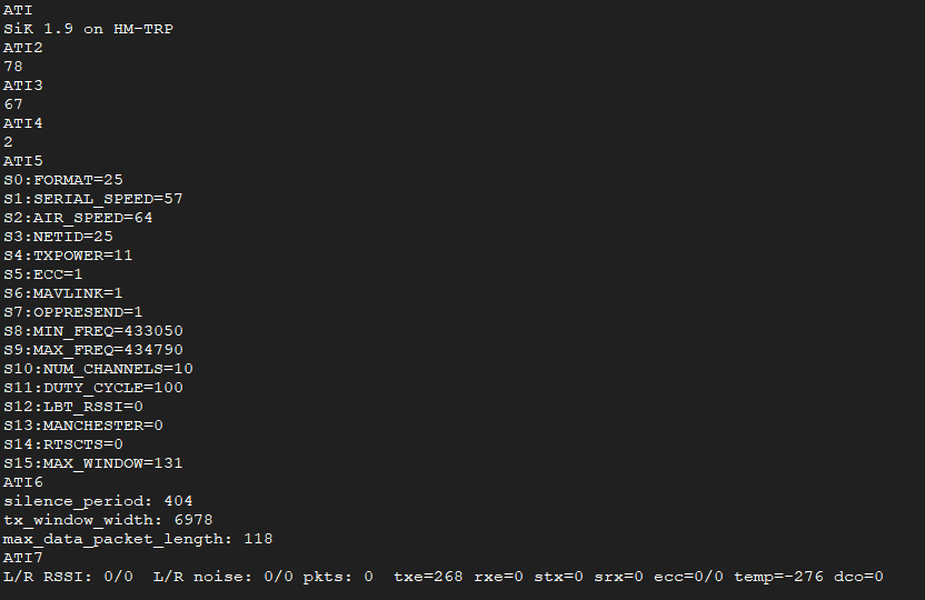

Here are the results of the default ATI commands for 2.0 (for both modules) before reverting back to 1.9:
Current behavior:
  • The air module blinks red and green, while the ground module only blinks green.
  • I tried both Pixhawk 2.4.8-PC and PC-PC, still no solid green light.
  • They never recognize each other (no solid green light).
  • According to the ATI7 command, the ground module shows high noise levels.

Here is my pieces:

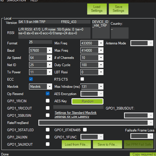

Here is the ATI Commands Results (CoolTerm) and Mission Planner Views for Both Modules
Ground Module
Mission Planers (I think MP always shows the wrong frequency range.)
Air Module

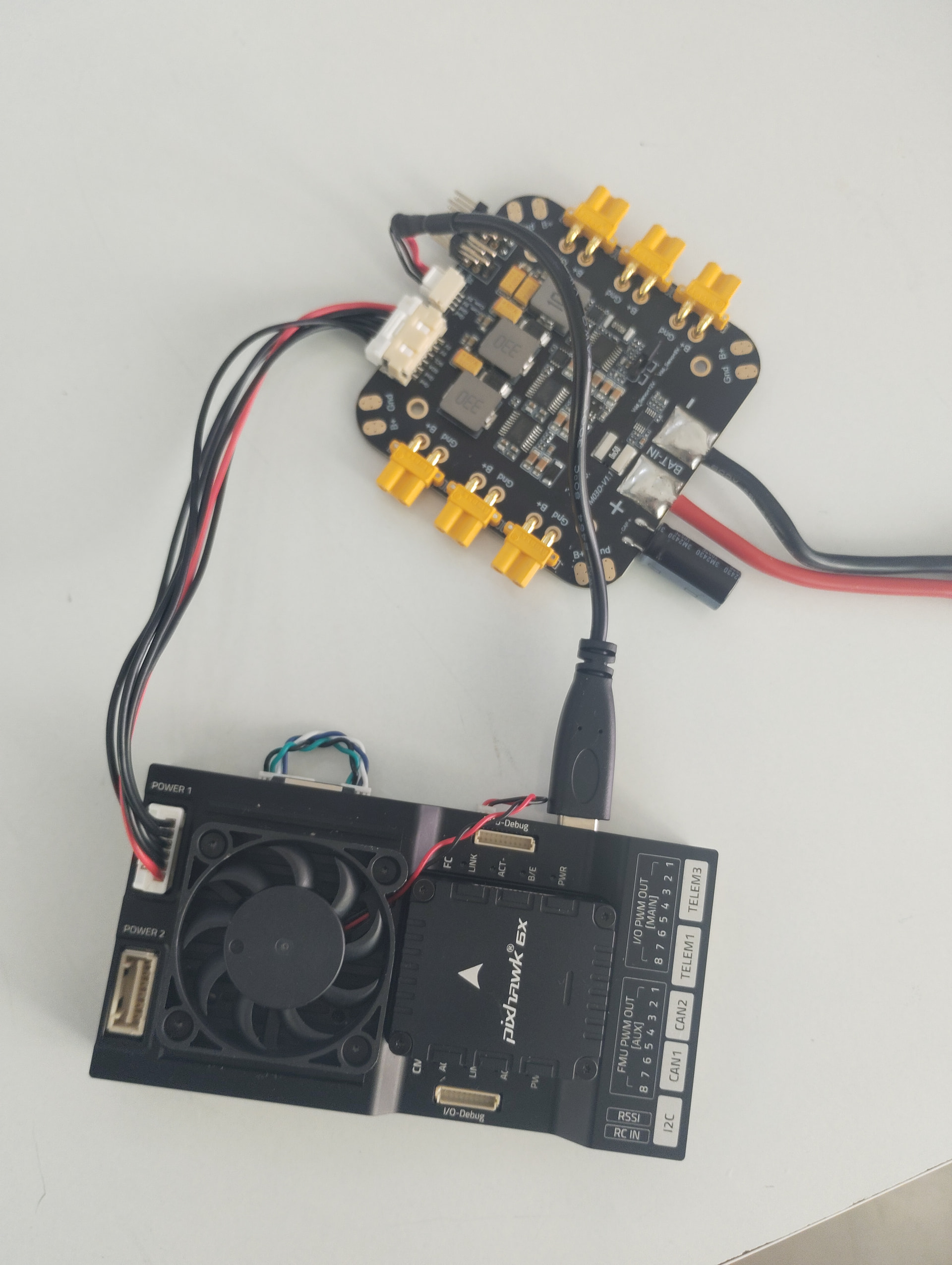

I am working in holybro baseboard pixhwak 6x and CM4 with similar situation. Can you help me with this
