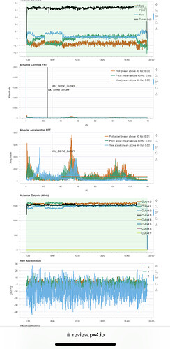

Hi guys,
@bresch I’m having vibrations near between 50Hz to 60Hz.
Now in such case should I set the notch Filter frequency and bandwidth only as a first step or better set the low pass filters GYRO CUTOFF & DGYRO CUTOFF?
what’s best practice & when to use Notch & when to use low pass or we should set both?
Thanks in advance
Hi, the static notch filter should be used when there is a structural resonance as this occurs at a fixed frequency. The gyro and DGyro lowpass filters are used to remove the high frequency noise in general.
If you have ESC telemetry, the best thing to do is to use RPM-driven notch filters. If you don’t have ESC telemetry, you can also set a notch that follows an FFT.
Documentation about dynamic notch filters is here: MC Filter Tuning & Control Latency | PX4 Guide (main)
In your case -from what I can see from the screenshot you shared- the noise doesn’t seem to be an issue for the control loops (the actuator outputs signals are quite clean). So unless you have RPM feedback from the ESCs, I don’t think you need to change much.

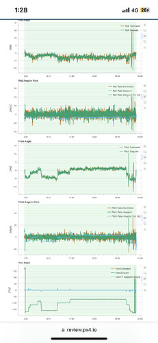

Hard to tell if the control loops are well tuned when the drone is hovering in place.
What’s the approximate size/weight? And the other rate gains (K, P, I)?
You could try the dynamic notch (FFT based), but if you say that you see “low frequency vibrations”, you might need to iterate on the tuning gains a bit.
If you have a log to share, it might be easier for me to help you.

Well, from your first picture, I would set a notch filter at 45Hz BW10 and another one at 55Hz BW10.
I usually set the D gains to 0, as in my experience they only amplify noise for a “big” drone like you have.
Finally, since you have a big drone, I would set the gyro cutoff and accel cutoff to 25Hz.
Let us know if that improves, and post the FFT plots with these new parameters :v::slightly_smiling_face:

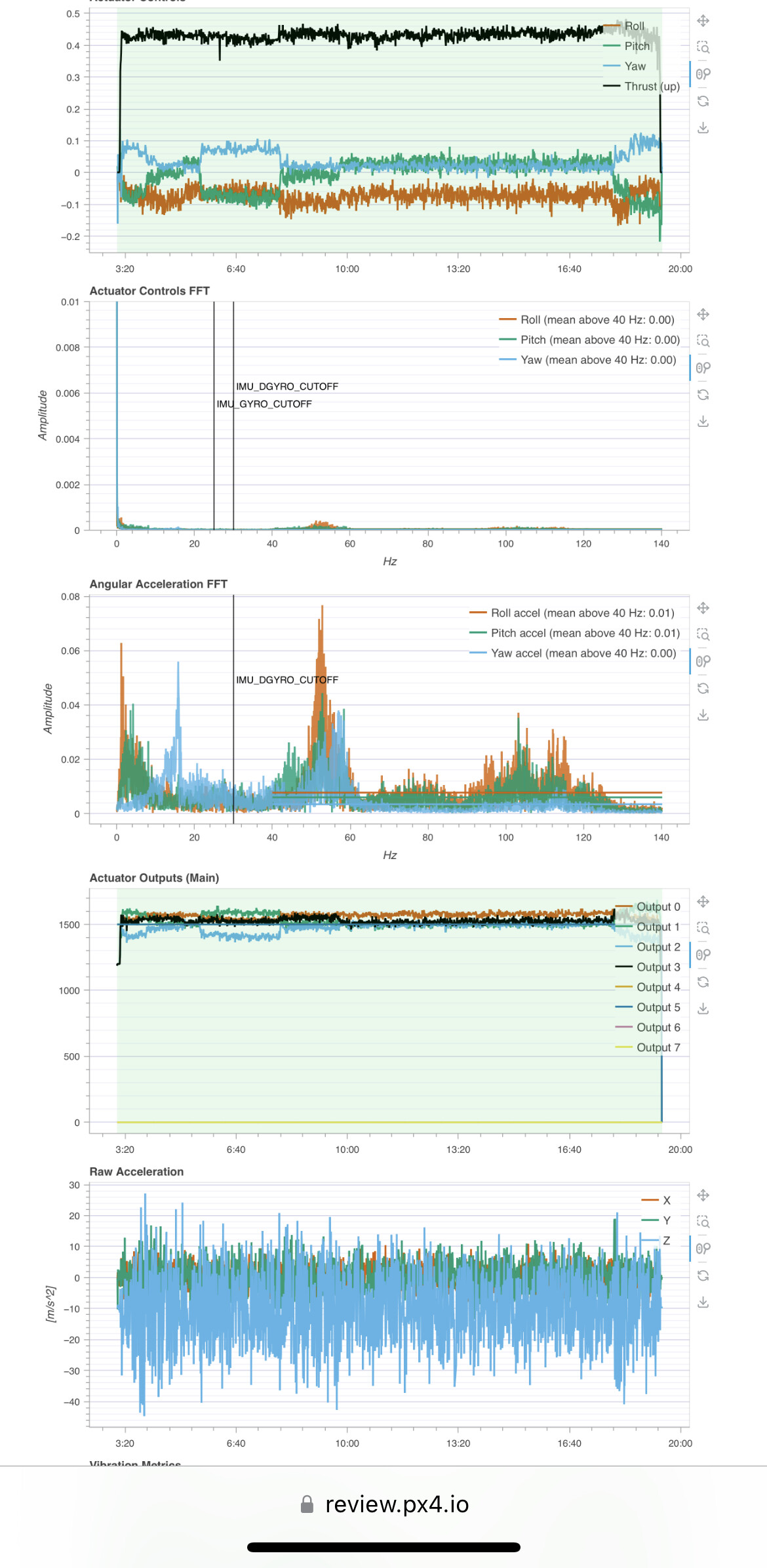

In the logs you sent me the roll and pitch vibrations look much better with the wider notch filter.
Your high acceleration noise on the Z axis is probably due to the roll and pitch vibrations. Not the yawrate.

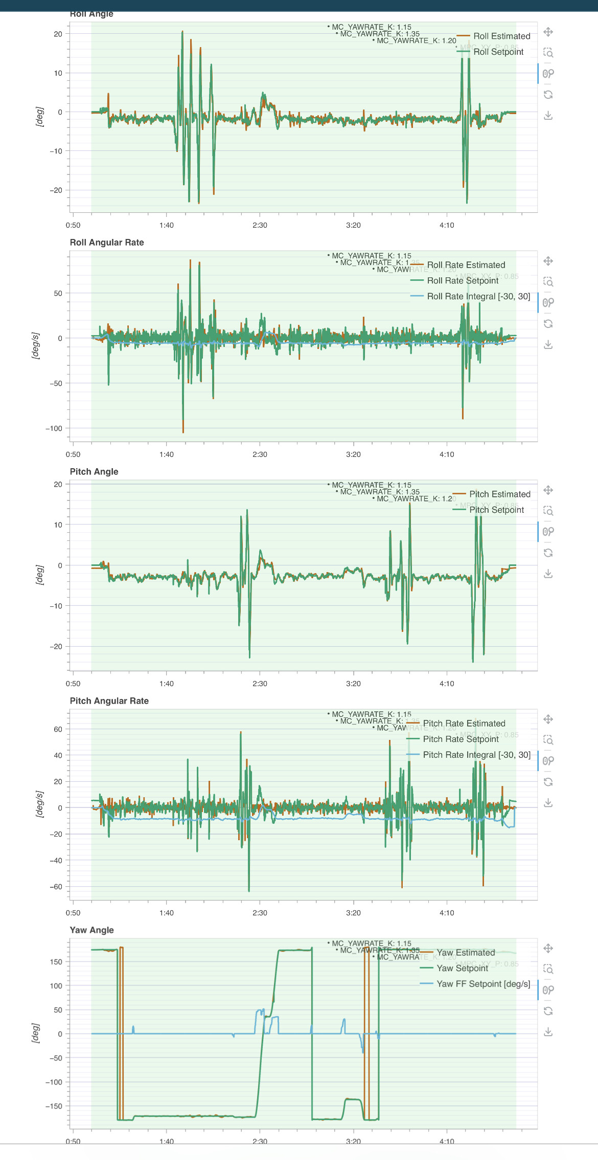

I think you pitch axis is a bit too aggressive (if you look at the PID analysis you’ll see your pitch step response is overshooting). You can try to reduce MC_PITCH_P to 6. And potentially the MC_PITCHRATE_* gains.
Otherwise there is not much more you can do to reduce these vibrations on the Z axis. The EKF was significantly improved on v1.15, so your vehicle might behave better. And yes, you’ll probably need to re-tune your vehicle.
To reduce the acceleration you can set the ACCEL_CUTOFF to 20 Hz.

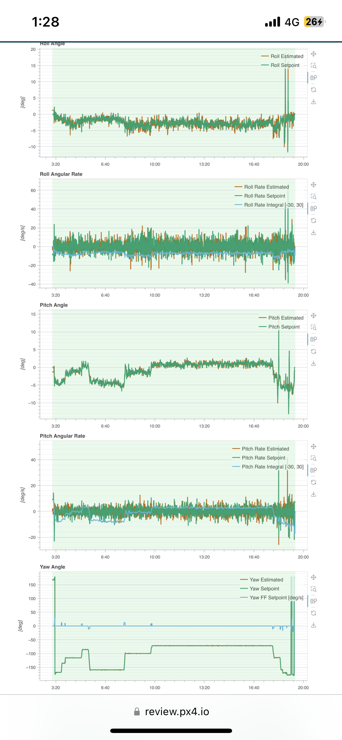

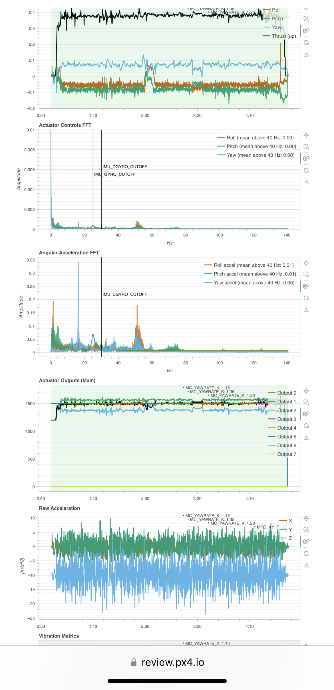

Hi @Romain_Chiappinelli @bresch
I made tests with & without gimbal camera and when flying without gimbal camera the vibrations is in acceptable levels but once I instal gimbal it goes up and I’m not sure what to do in this case!
Without gimbal camera:
With gimbal camera:
I really don’t know what I should do in this case!
I kindly hope you can advise.
Thank you in advance
Kindly advise what suggestions you have to reduce these vibs
