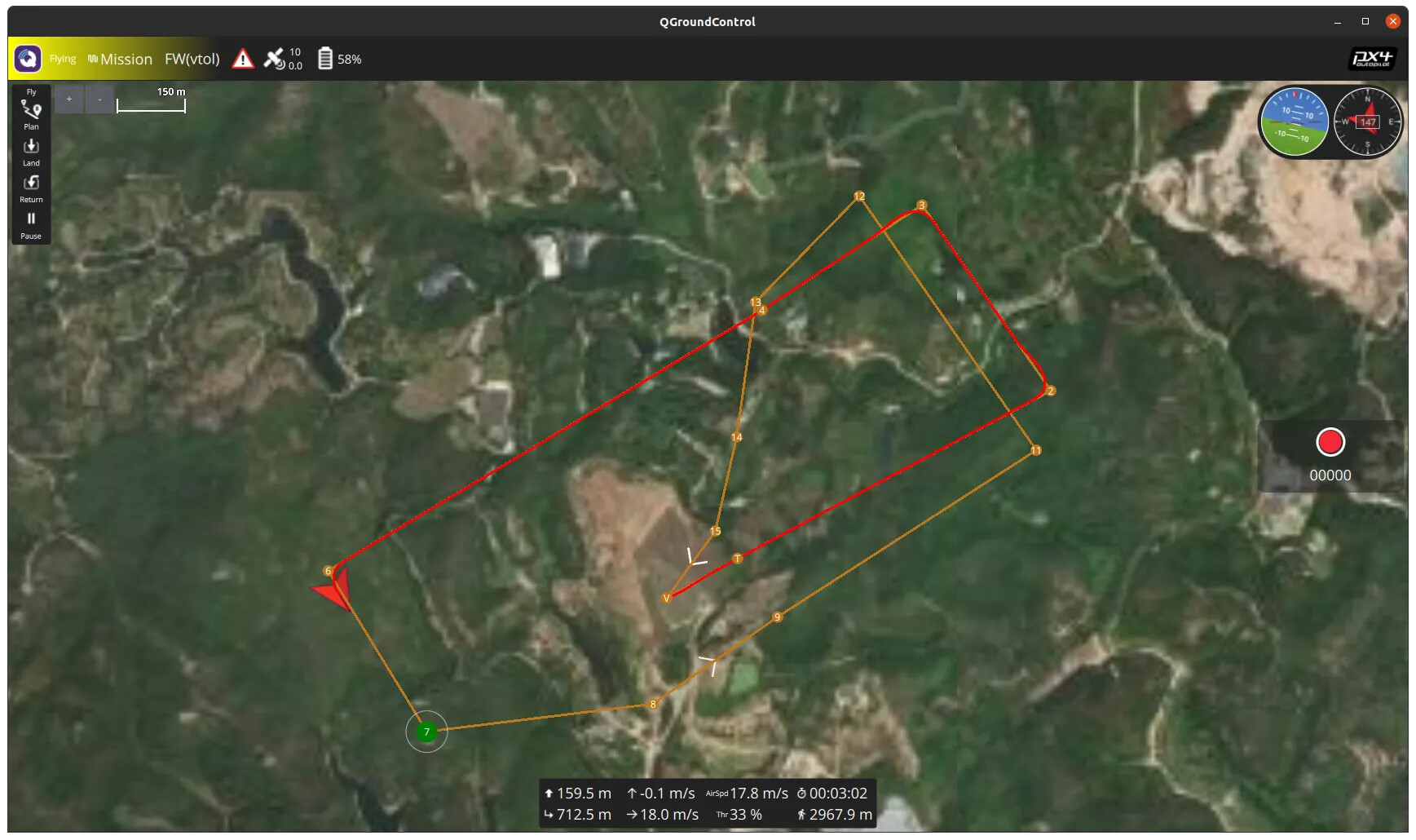

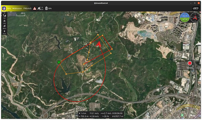

We are trying to reproduce and investigate the issue of Flight #1 in Unexpected and dangerous behaviours after going in & out of Offboard mode. Basically, we are testing with ROS2 Offboard control and now we are in the very first test, the test procedure is as follows:
  • Start a Python script, waiting to send commands in ROS2 topic;
  • Upload a plan in QGroundControl, including position waypoints and one change_speed waypoint;
  • Start mission in QGC;
  • The script keeps waiting until near a certain GPS coordinate (coordinate of waypoint #5 in our case), then it sends command of switching into Offboard mode;
  • The script deliberately exits, let PX4 fallbacks into Position mode;
  • Mannually switch into Mission mode in QGC;
The reason why we deliberately let the code exits is that, we are trying to investigate Flight #1 in Unexpected and dangerous behaviours after going in & out of Offboard mode, where we were supposed to switch into Offboard mode for 1 second, but the code raised an error and exited, then the VTOL kept descending then crashed into the ground.
We repeated several times and found out that in some cases, the VTOL (standard_vtol to be specific) kept descending then crashed on the ground, but in other cases it followed the waypoints as normal.

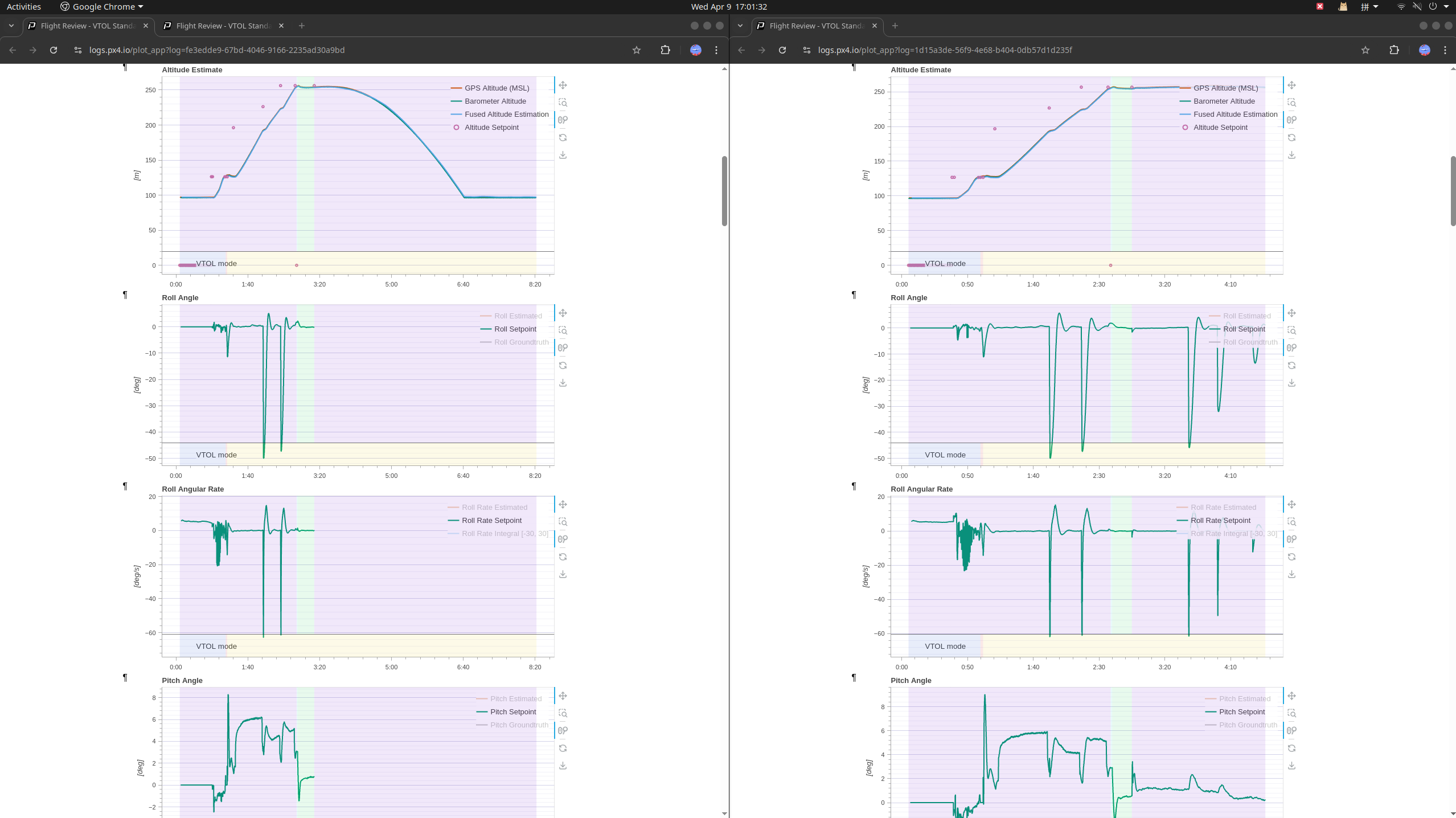

We just found out that in runs that VTOL eventually crashed, body angle setpoints (green lines in the plots) just vanished after switching back to Mission mode. On the contrast it stays alive in the normal runs. Here we compared Crash #1 to Normal #1.
We think that is strongly related to the crash issue, but we still couldn’t figure out exactly why.
