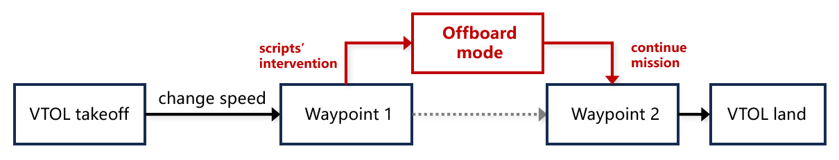

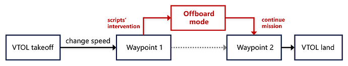

Test Procedure
Both of the two flights were supposed to test Switching between Mission Mode and Offboard Mode. The procedure is as the figure below depicts.
Before takeoff, a plan of several waypoints is uploaded through QGroundControl.
The script running on the companion computer:
- starts before takeoff;
- waits until the drone reaches a certain waypoint (#1 for example in the figure);
- sends a signal of switching into Offboard mode;
- controls the drone in body rate / thrust command (0 in roll & pitch & yaw rate, 0.3 in thrust) for 1 second;
- sends a signal of switching back to Mission mode;
- sends a signal of switching into multi-copter (MC) configuration;
- waits for transition into multi-copter configuration to be completed;
- sends a signal of switching into fixed-wing (FW) configuration;
- waits for transition into fixed-wing configuration to be completed;
- exits.

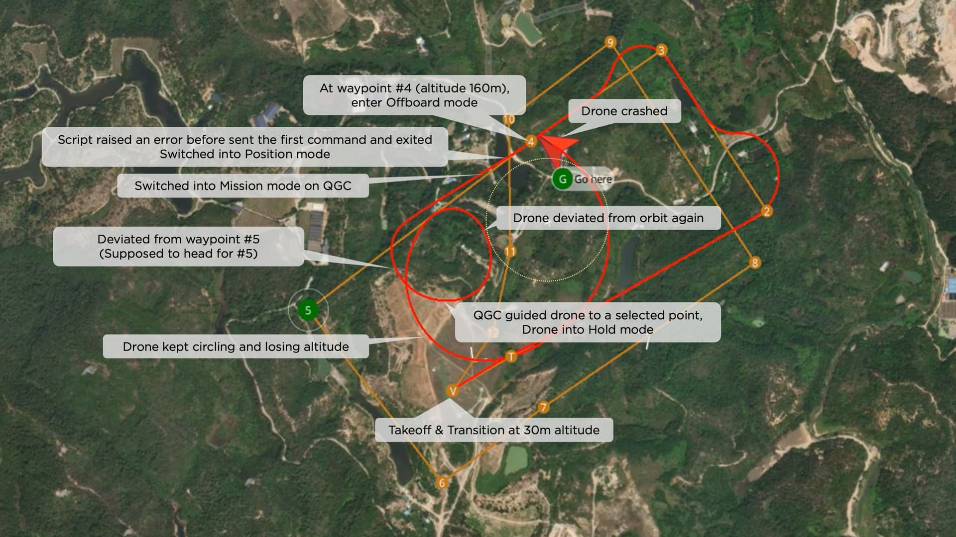

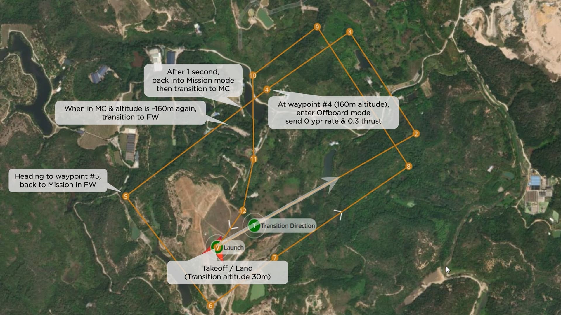

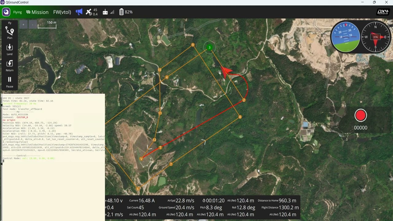

Flight #1
The first attempt of this test caused a crash. After successfully switched into the offboard mode, the script encountered an error and exited. All attempts of guiding the drone to land by QGC failed.
- The drone wouldn’t head for waypoint #5 as it was supposed to after switching back to Mission mode by QGC.
- The drone wouldn’t loiter at the point of QGC’s command.
- The drone was constantly decreasing altitude (but didn’t seem like stall).
Mission Plan
Complete Trajectory
QGC Screen Recording with Onboard Computer
Detailed Record
ID for Reference Operation / Behaviour Step of Script Process Timestamp In Video 1-1 The script started Step 1 0:01 1-2 The drone takeoff-ed and followed the mission plan Step 2 0:11 1-3 When the drone reached waypoint #4, the script successfully sent the signal to switch into Offboard mode Step 3 1:56 1-4 The script encountered an error and exited Step 4 1:56 1-5 The drone switched into Position mode immediately 1:57 1-6 QGC controller switched the drone into Mission mode to let it continue the mission 2:10 1-7 The drone didn’t follow the direction of waypoint #5 2:20 1-8 QGC controller selected a point on the map and attempted to guide the drone to loiter around this point 2:30 1-9 The drone switched into Hold mode, and didn’t go for the correct direction; meanwhile, the drone was decreasing altitude and gaining airspeed to more than 30m/s 2:39 1-10 The drone kept flying in a circle with ~300m radius while constantly decreasing altitude 2:55 1-11 The drone crashed 3:28
Confusion
- [1-7] Why the drone didn’t head for waypoint #5?
- [1-8, 1-9] Why the drone didn’t head for the selected point and began to lose altitude?

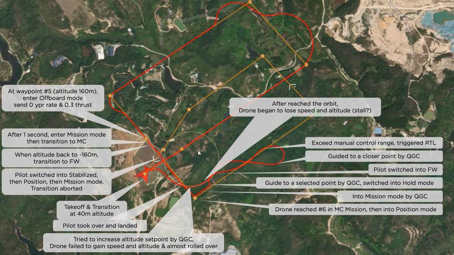

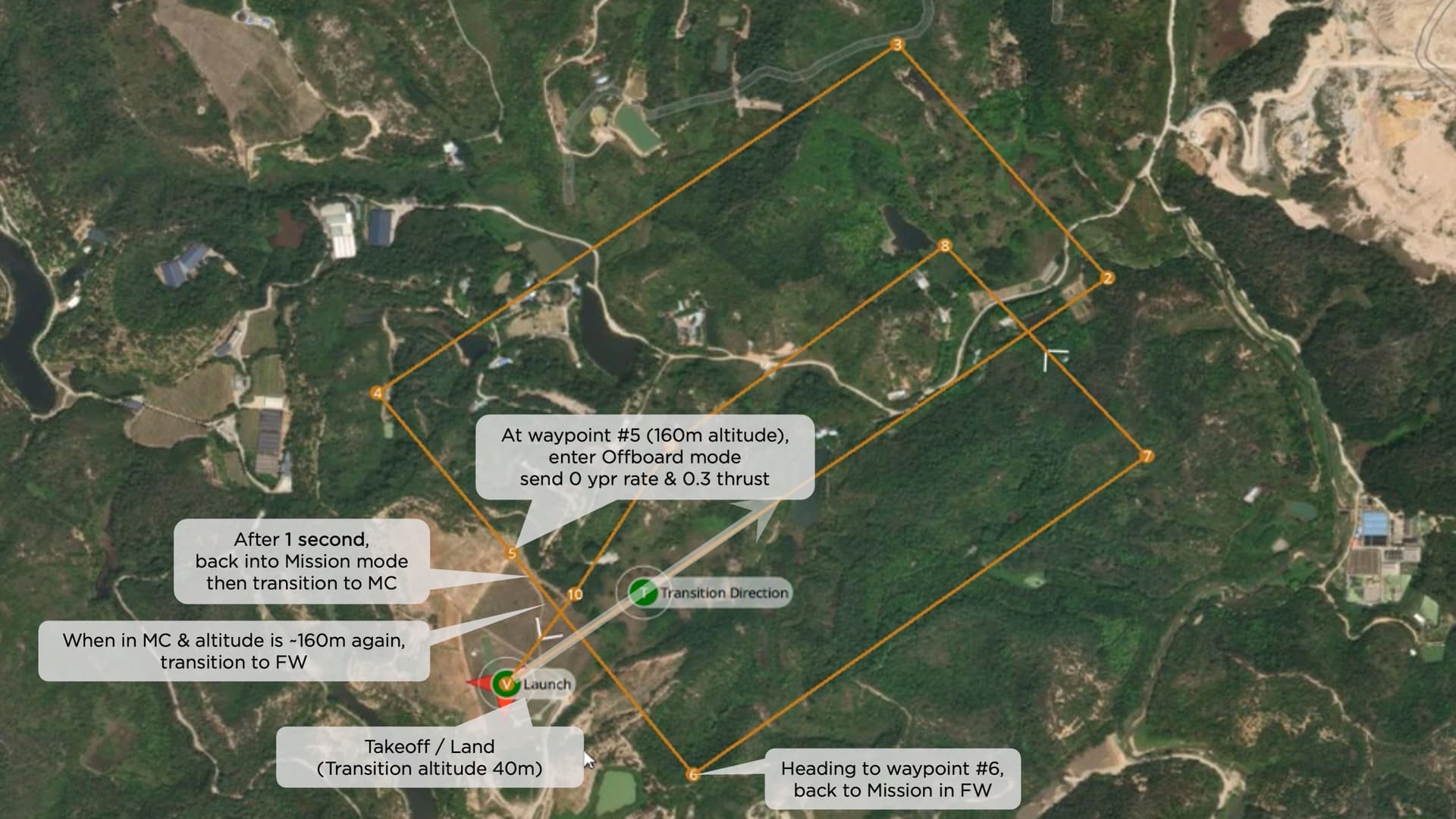

Flight #2
The second attempt was successful when:
- The script sent the command into Offboard mode.
- Kept sending 0 ypr rate & 0.3 thrust command for 1 second.
- Sent the command back into Mission mode.
- Sent the command of transition to MC.
- Wait for the drone to slow down and finish transition.
- Sent the command of transition to FW.
- Wait for the drone to accelerate and finish transition
Then the pilot took control of the drone just before the transition was completed. ****The operations afterwards:
- The pilot switched into Mission mode again.
- The drone headed for waypoint #6 in MC.
- QGC guided the drone to a selected point then switched into Mission mode.
- The pilot switched into FW in Hold mode.
- The drone reached out of manual comm range and triggered RTL.
- QGC guided the drone to a point near home.
- The drone reached the orbit.
Then the drone had some unexpected and dangerous behaviours.
- The drone kept losing altitude and speed, seemed like stalling.
- QGC reset altitude setpoint, attempting to increase altitude.
- The drone kept losing altitude, then after a serval seconds, almost rolled upside down.
- Quad-chute was triggered.
- The pilot took over and landed.
Mission Plan
Complete Trajectory
Detailed Record
| ID for Reference | Operation / Behaviour | Step of Script Process | Timestamp In Video |
| 2-1 | The script started | Step 1 | 0:00 |
| 2-2 | The drone takeoff-ed and followed the mission plan | Step 2 | 0:21 |
| 2-3 | When the drone reached waypoint #5, the script successfully sent the signal and the drone switched into Offboard mode | Step 3 | 3:04 |
| 2-4 | The script controlled the drone for 1 second | Step 4 | 3:04 |
| 2-5 | The script sent the signal to switch into Mission mode | Step 5 | 3:05 |
| 2-6 | The drone re-entered Mission mode successfully | 3:05 | |
| 2-7 | The script sent the signal to switch into multi-copter (MC) configuration | Step 6 | 3:06 |
| 2-8 | The drone took ~8 seconds to decrease speed and finished transition into multi-copter configuration | Step 7 | 3:13 |
| 2-9 | The script sent the signal and attempted to switch the drone into fixed-wing (FW) configuration | Step 8 | 3:14 |
| 2-10 | The drone accelerated, almost finished transition | Step 9 | 3:17 |
| 2-11 | Manual controller took control and switched into Stabilised mode, then Position mode | 3:19 | |
| Manual controller switched into Mission mode | 3:23 | ||
| 2-11 | The drone decelerated while approaching waypoint #6 | 3:27 | |
| 2-12 | After reaching waypoint #6, the drone switched into Position mode | 3:43 | |
| 2-13 | QGC controller let the drone re-entered Mission mode and headed for waypoint #7 | 3:52 | |
| 2-14 | QGC controller guided the drone to a selected point on the map, the drone entered Hold mode | 4:28 | |
| 2-15 | Manual controller switched into fixed-wing configuration | 4:45 | |
| 2-16 | The drone accelerated and transitioned successfully into fixed-wing configuration in Position mode | 4:51 | |
| 2-17 | The drone exceeded manual control range and triggered RTL | 4:56 | |
| 2-18 | QGC controller guided the drone to a point closer to takeoff point | 5:10 | |
| 2-19 | The drone switched into Hold mode | 5:10 | |
| 2-20 | After reached the orbit, QGC controller noticed that the drone was losing airspeed and altitude, seems like stalling | 5:31 | |
| 2-21 | QGC controller re-selected altitude setpoint to be higher | 5:44 | |
| 2-22 | The drone failed to re-gain altitude, and after a few seconds, the drone suddenly rolled over | 5:53 | |
| 2-23 | Quad-chute emergency was triggered and the drone switched to multi-copter configuration | 5:54 | |
| 2-24 | Manual controller took control and landed the drone | 6:03 |
Confusion
- [2-20, 2-21, 2-22] Why the drone lost height & speed and rolled almost over?
