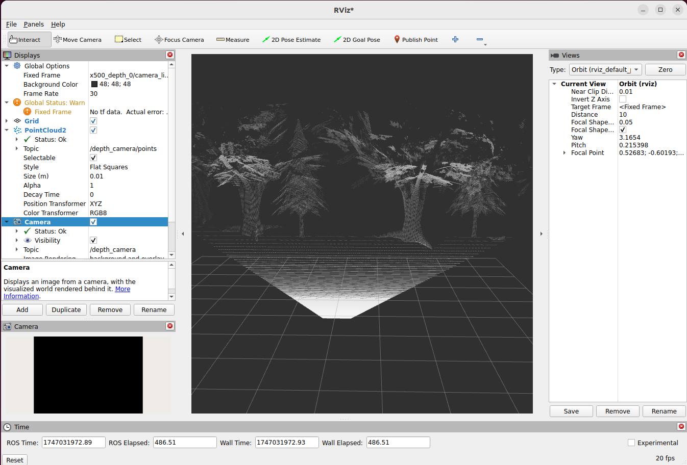

@Pratik_Wagh Do you find any solution? I have a similar problem, manage to getting a fixed frame in rviz launching manually static_transform_publisher, but still no data displayed.
YEAH. JUST select the topic u want to visualize in rviz then a msg in ur rviz’s terminal (where u launched the rviz2 command) in which the msg will say a frame name in ā€œā€ (double quotes) just copy from terminal and enter the frame name in rviz2 where ā€œmapā€ is written by default
this is how i found the frame name
hope this helps

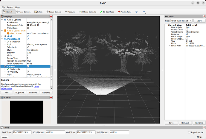

Thank you, that helps a lot! Now I can see the point cloud, but still i’m not able to see camera data displayed. Are you using different settings than default in rviz2 for the camera? I have tried several but unsuccessfully.
My setup
ROS2 humble, PX4 SITL with default setup for Ubuntu 22.04, ros-gz from source
PX4_GZ_WORLD=forest make px4_sitl gz_x500_depth
ros2 run ros_gz_bridge parameter_bridge /camera@sensor_msgs/msg/Image@ignition.msgs.Image /camera_info@sensor_msgs/msg/CameraInfo@ignition.msgs.CameraInfo /depth_camera/points@sensor_msgs/msg/PointCloud2@gz.msgs.PointCloudPacked /depth_camera@sensor_msgs/msg/Image@ignition.msgs.Image
rviz2

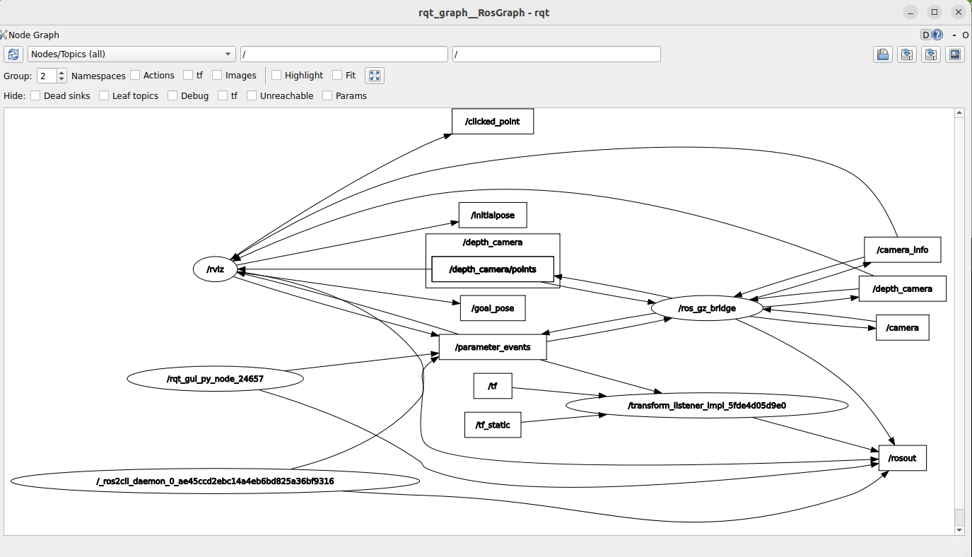

I’m not receiving errors or warning and also ros2 echo shows messages are being published. The only interesting log on rviz2 terminal I get is [INFO] [1747033002.560393429] [rviz2]: Stereo is NOT SUPPORTED at startup and each time i try to visulize camera or image.
Here are screenshot from rviz2 and rqt_graph window

I am facing the same problem. I see the map frame set to camera_link but that doesn’t work when I try to visualize the point cloud. I am able to visualize the image.
to visualize different topic u have to select their respective frame
if the log terminal of rviz shows queue error while visualizing specific topic u will also see its frame in the log just copy and paste it to rviz’s terminal
