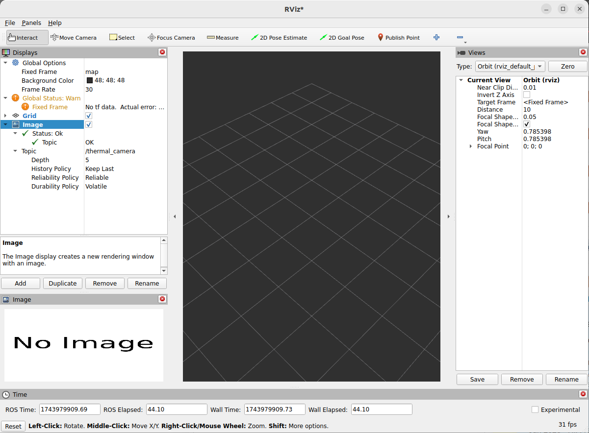

ros2 run ros_gz_bridge parameter_bridge /thermal_camera@sensor_msgs/msg/Image@gz.msgs.Image
[INFO] [1743979773.704502650] [ros_gz_bridge]: Creating GZ->ROS Bridge: [/thermal_camera (gz.msgs.Image) -> /thermal_camera (sensor_msgs/msg/Image)] (Lazy 0)
[INFO] [1743979773.707870940] [ros_gz_bridge]: Creating ROS->GZ Bridge: [/thermal_camera (sensor_msgs/msg/Image) -> /thermal_camera (gz.msgs.Image)] (Lazy 0)
#Terminal 4: rviz2
I have no idea why this is not working for me. It works for two of my co-workers who have had PX4 for 2 years on their laptops. However, everyone else who just downloaded PX4 (by just I mean over the past 8 months) does not have image topic working on rviz2. I would love and appreciate any help regarding this
This is the camera topic. When you bridge it, you have to define a static tf transform between the sensor frame and the base_link frame and then broadcast a tf transformation between the base_link and the map frame. This way you can visualize the camera feed in RViz. Otherwise, you can also use rqt_image_view or an application like Foxglove.
P.S. You should start with using the Image Display option in Gazebo to check if you have a camera feed.
