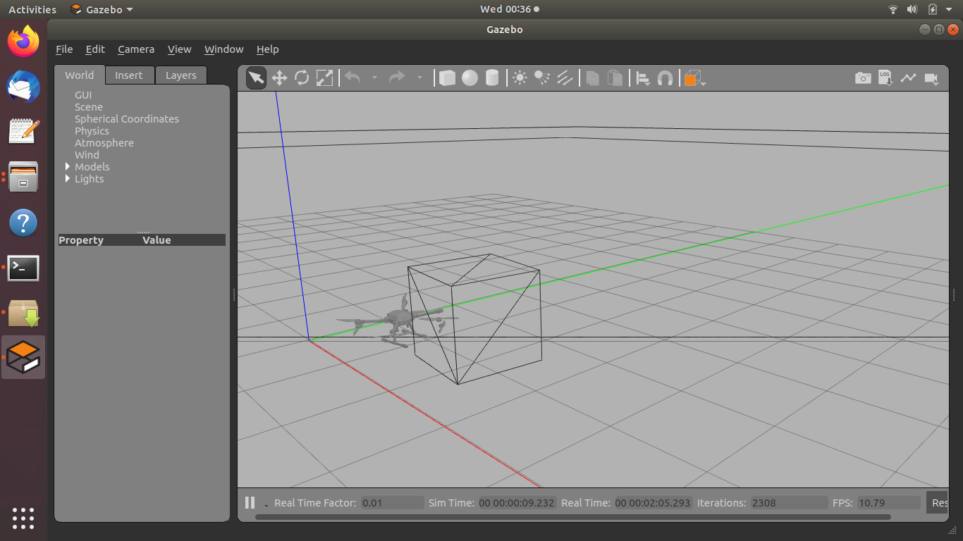

I have another doubt
You can see the floating propellers even though I have selected the entire thing in solidworks while converting to urdf. Pls help.
