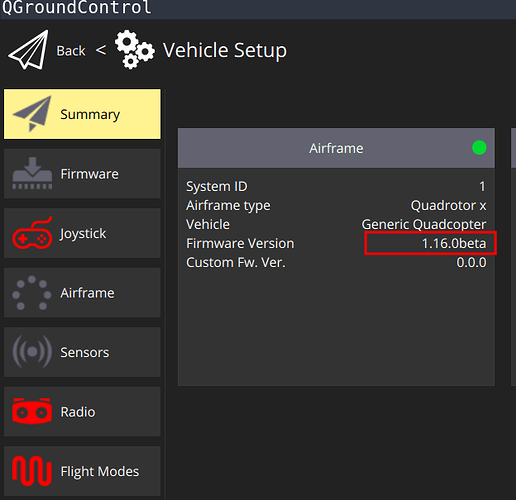

Which PX4 version are you flashing?
And check this parameter:
Hello, I’m not sure of the exact PX4 version and I do not see that parameter listed. However, I am able to access the /dev/ttyUSB0 port after going into the /dev/ttyACM0 and updating the bootloader through there.
Check in QGC:
Or got to Analyze tools → MAVLink shell → ver all.
