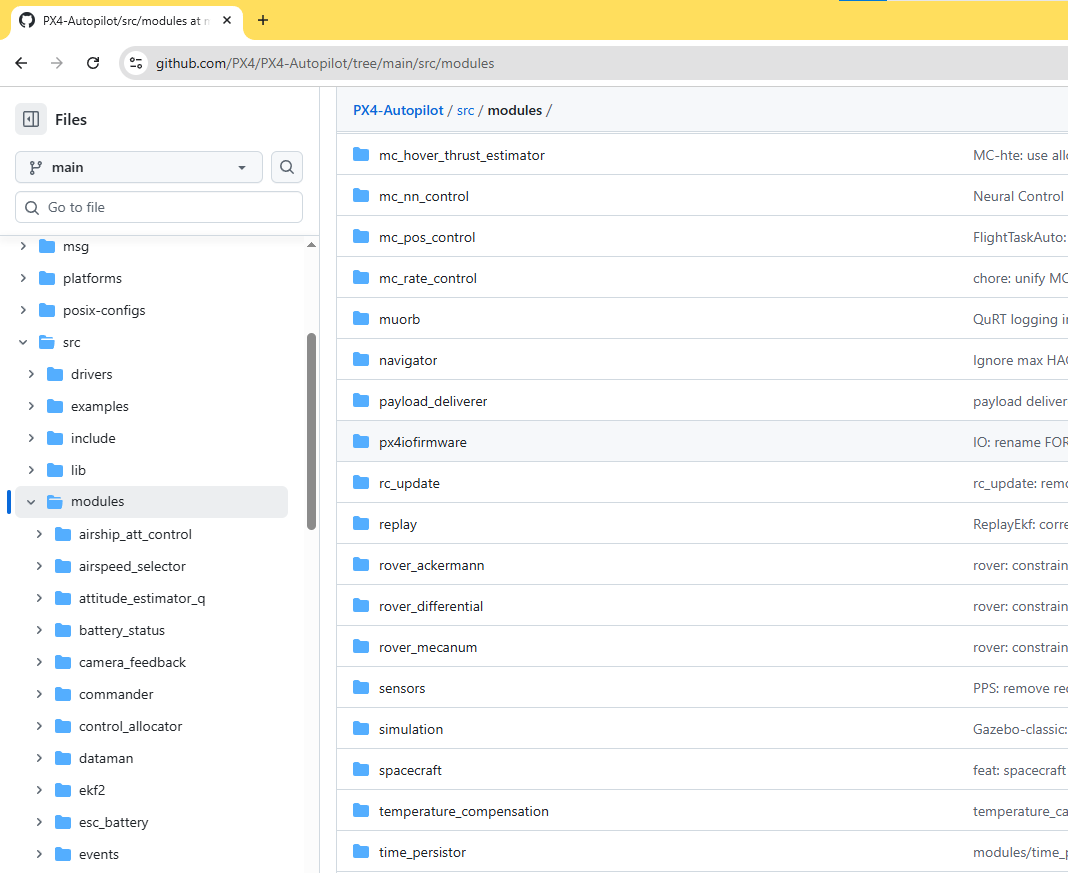

I started poking around the version 1.16 repository - and I’m not sure CRSF support is in there.
My research indicated that there should be a directory in the repo: src/modules/rc/crsf
But it doesn’t seem to exist:
Can someone please point me in the right direction so I can generate a custom PX4 with support for CRSF and ELRS. (ELRS needs 420000 baud)

It’s a bit unclear in regard to RC protocols and drivers, there are 2 ways to include CSRF:
PX4-Autopilot/src/drivers/rc
or
PX4-Autopilot/src/drivers/rc_input
I think co-pilot is failing you, try Claude. Also a quick google search should have gotten you there.
You shouldn’t need a custom build, all that is required is CONFIG_COMMON_RC=y or DRIVERS_RC_CRSF_RC=y in the .px4board for the target you’re using. Also ensure RC_CRSF_PRT_CFG param is set and that nothing else is configured on that port.

Indeed - I had gotten bad direction from Microsoft Co-Pilot on this issue.
I posted about it on the FaceBook ELRS group and got a reply back from Chris Seto - who wrote the current PX4 CRSF driver. He helped point me in the right direction.
I learned that PX4 has the ability to easily include or exclude modules or drivers using the “make” process. (using boardconfig) Chris got me headed that way by sharing his post: Reptile Dragon 2 (RD2) Build | PX4 Guide (main)
