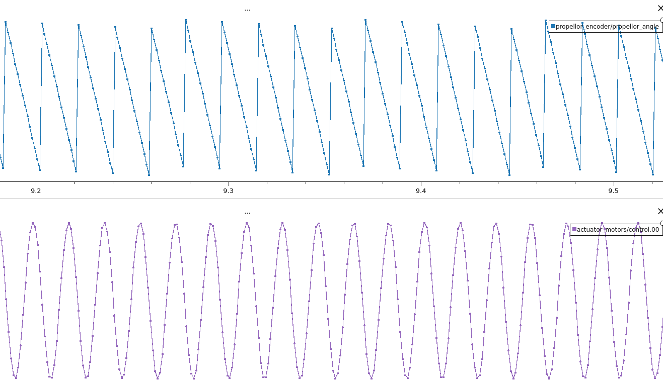

I having some problems with the throttle value coming out on the DSHOT pins not matching the value published on actuators_motors.
I read the DSHOT throttle value using a logic analyzer with support for DSHOT and tracked the actuator_motor value using the logger module and PlotJuggler but I cant make sense of where the data is being lost/lowpassed to a constant value.
The DSHOT data is being sent physical at approx. 790Hz which is the same as the rate_ctrl workqueue update rate since the DSHOT/mixer is running on the rate_ctrl queue. Therefor actuator_motor is being updated the same rate.
But the sinusiodal on the throttle signal is lost and throttle is constant instead. And I cant figure where in the code this happens
Any insight?
