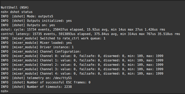

I don’t know if that is any help, but this is the output of the dshot status command. (Sorry for the image, I could not copy from QGC.)
The AUX mixer seems to loaded, as if I comment out the part where it loads in rc.interface file (PX4-Autopilot/rc.interface at main · PX4/PX4-Autopilot · GitHub) the dshot signal disappears on the AUX ports. (And I have dshot signal in the first three pins, just as I have three mixers in the AUX mixer file.) Also, it is loaded from etc/mixers/ folder.
