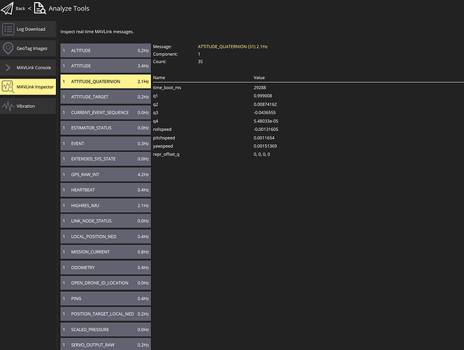

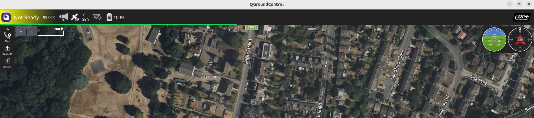

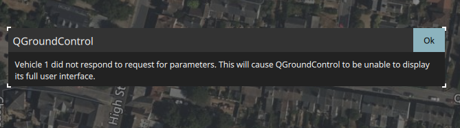

My telem radios are connected and talking from my FC to my laptop but I get the same error that the vehicle does not respond to a request for parameters. The green bar also just pauses halfway on the initial load.
I am using a kakute v1.3 fc which has been flashed with the custom version of the latest make holybro_kakuteh7_default(to add elrs and move telem1 to uart3)
My radios are 433 MHz holybro sik telem radio
Both radios are on baud rate 57600/ i do not have flow so that has been turned off. I moved telem1 to uart3 as uart1 did not work for me

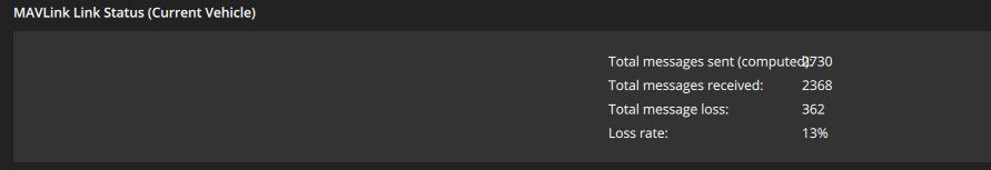

Here is my mavlink messages whne connected via telem radio. messages are being sent jsut seems way too slow to even do anything though. USB does work fine and I have tried another set of new holybro radio and that did the same
