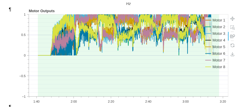

This is the longest log I have. The yaw seems awfully underactuated. There is also a lot of noise on the pitch and roll graphs. I didn’t do a sensor calibration before the flight, as I have done it in the same place a month ago. This seems to have worsened the behaviour of the drone. The pixhawk is soft mounted, should i try to hard mount it onto the frame (Pixhawk 6x). Any reply about the details of the yaw controller in the coaxial configuration ? Maybe, someone with experience in PX4 flight control architecture can help !

This doesn’t look well tuned. Your gains look way too high. Look at the motor outputs. What is the size and weight of this airframe?
The tuning parameters are all stock. The ESCs were calibrated. The diagonal of the drone is 1.9m and the weight is 22 kg.
The stock parameters will not work well for a large copter. You definitely need to tune.
Wow .txt file format is not supported here :joy: Message me on Discord (@dakejahl) and I will share with you a param file from a 1m diagonal 25kg Octo-coax.
