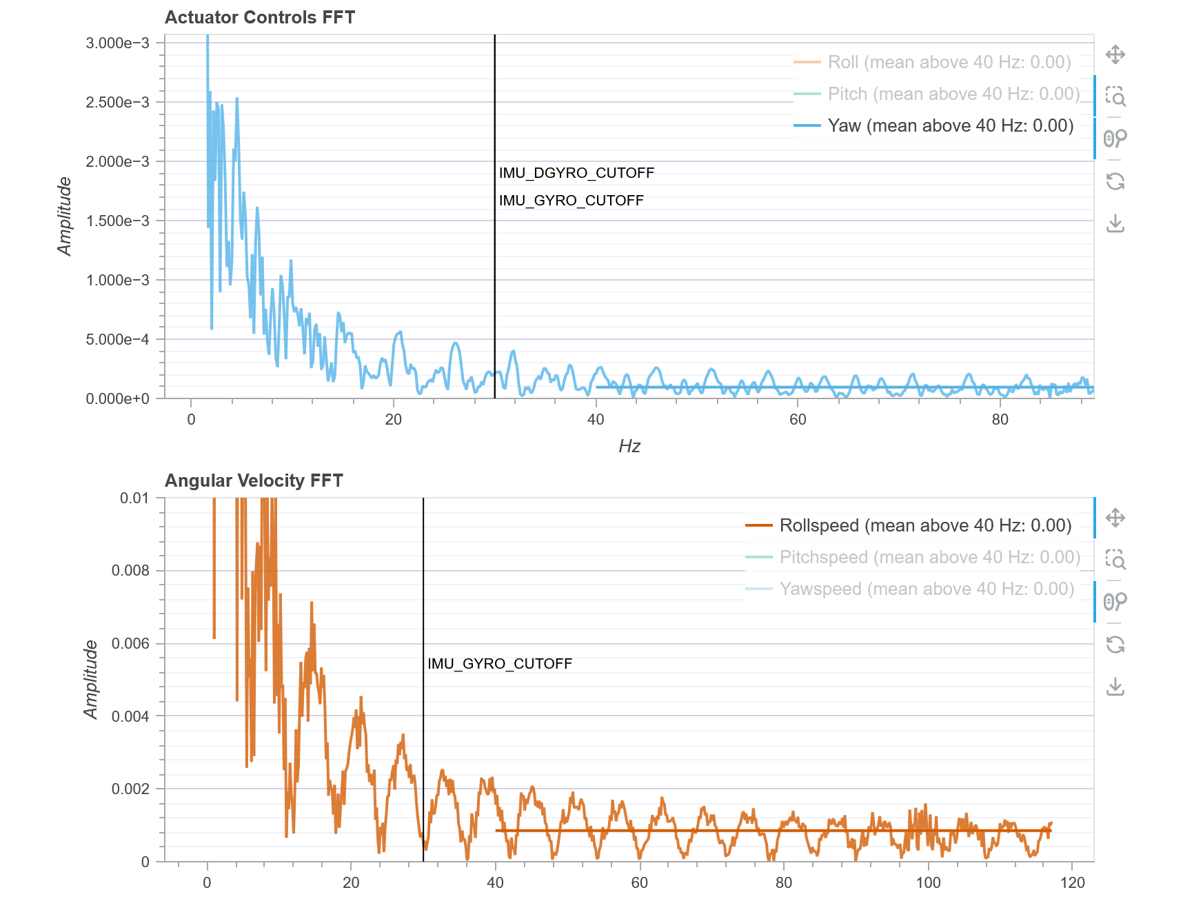

As you can see from the yaw angular rate graph, the yaw rate integral keeps increasing over time. As a result, motor outputs are diverging in pairs — motors 1 and 2 versus 3 and 4. This indicates that the propellers may not be generating enough force for yaw control. Alternatively, it could be that the magnetic field is being disturbed, causing the axis to drift.

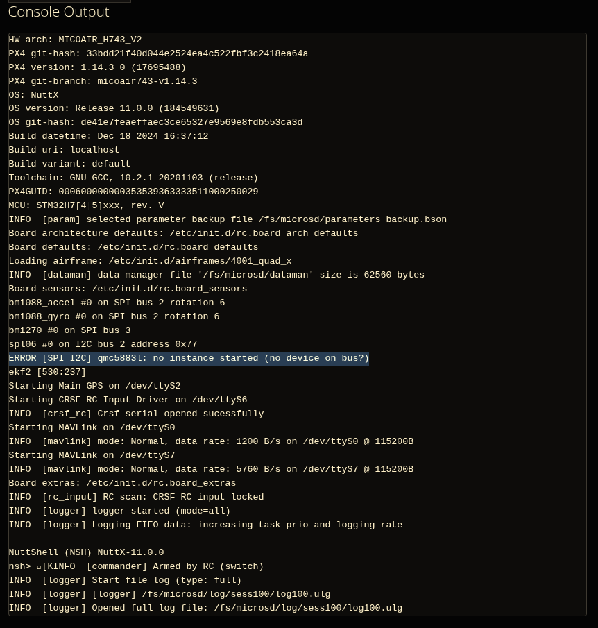

QMC5883L has not work.
there is no mag chip on board (no gps no other mag chip, maybe just default firmware settings). I think it will no affect the yaw if there is no mag.
It seems that your efforts have been effective — the divergence in motor outputs has decreased. The vibration levels also don’t appear to be a significant issue. It looks like the remaining problem is related to gain tuning of the rate controller.

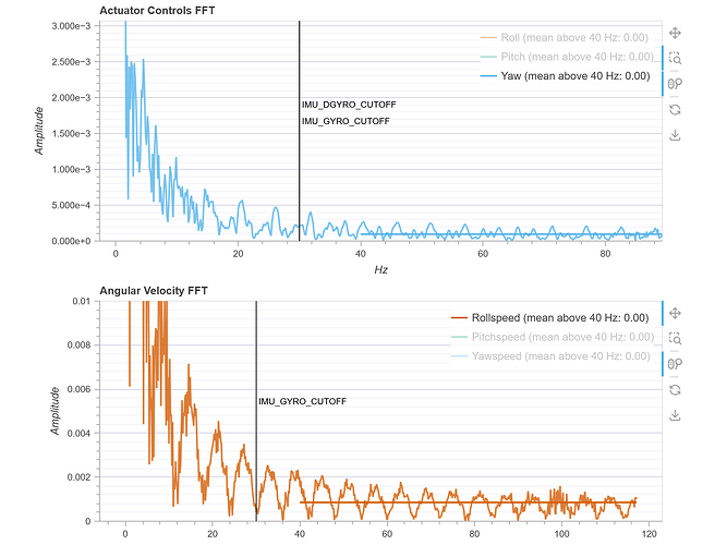

  1. Here is P0.4 I0.4 FF0.3
  1. Here is P0.45 I0.35 FF0.3 (NOT GOOD, yaw oscillation)
  1. Here is P0.35 I0.35 FF0.3, it fles ok, but quite a lot of pitch vibration. I don’t have any idea.
