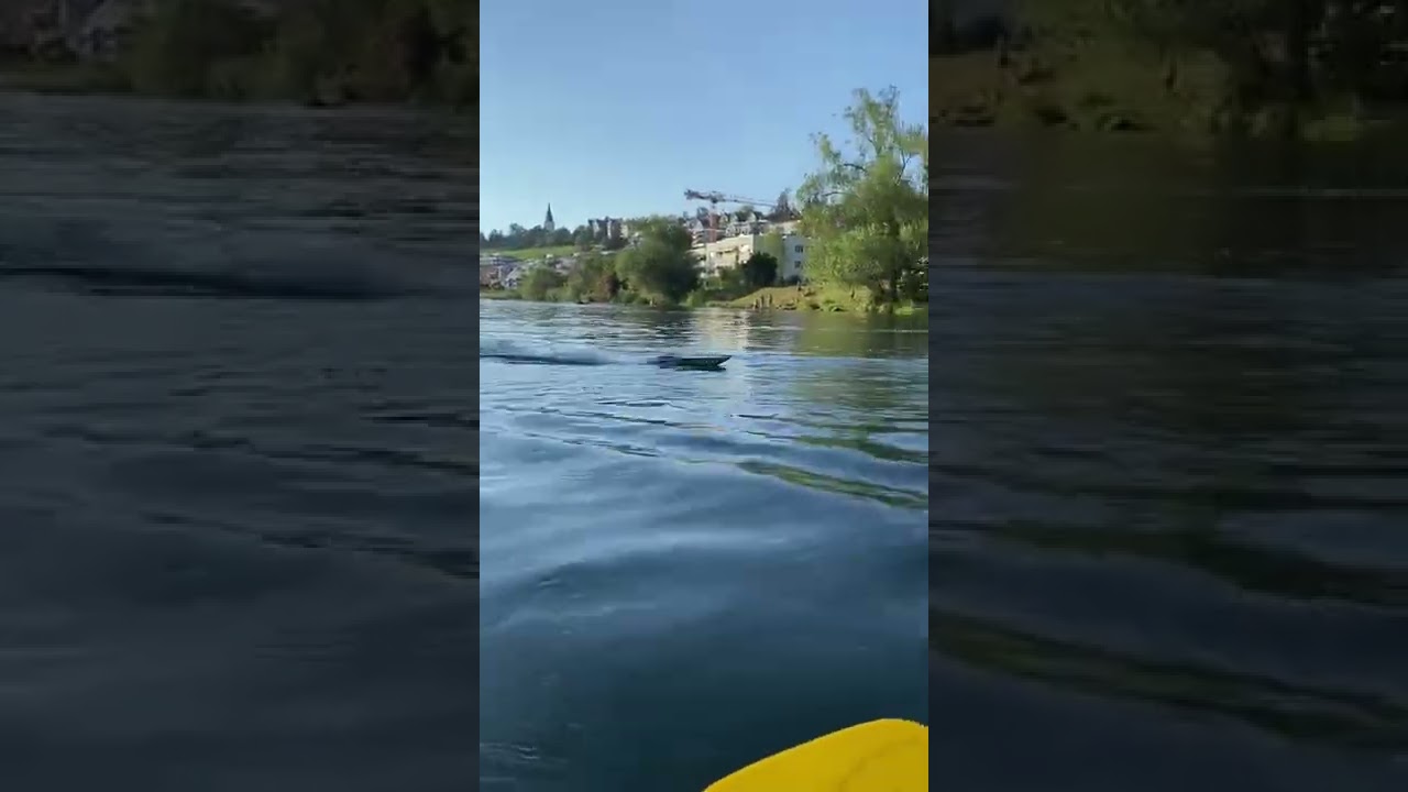

Limatt River Test
Here’s a snippet video that shows what the behavior of the boat was like. You can probably tell that it’s quite snappy and fast and reactive (especially when the speed is higher!)
And here’s a pic of the boat, next to the boat I was riding on :rowing_man:
